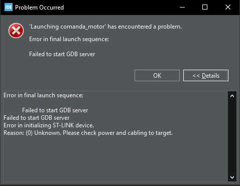

Launching 'project_name' has encountered a problem
luciscamatore

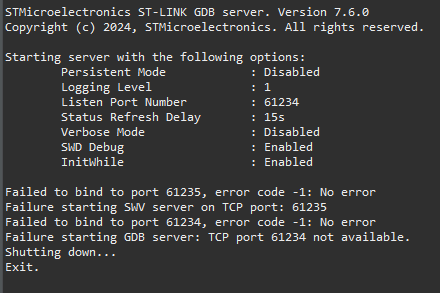

Hello all, I just updated my STM IDE and now, if I want to upload or debug my code I get this errorsimage_2024-04-07_142617974.png
An this is the output in the console:

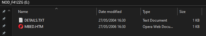

My computer finds the board as usual:
I tried powering off the board, switching the port, but it did not work, if you have any ideas I would be grateful. Thank you!
1 REPLY 1
Pavel A.
Try to move to different TCP port numbers.
