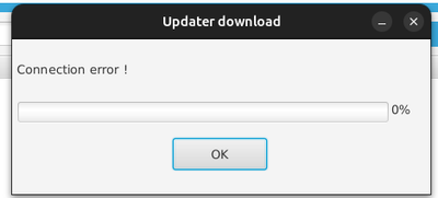

Upon launching STM32 CubeProgrammer today, I encountered this dialog:
In case the image doesn't show, the text reads:
The server connection is not established.
The network connection is required to download updates.
Please check your Proxy Settings.
This thread refers to the same error and is marked "Solved" but the solved problem is actually a different error, described in the same thread.
This message does not interfere with programming, but I'd sure like it to go away.

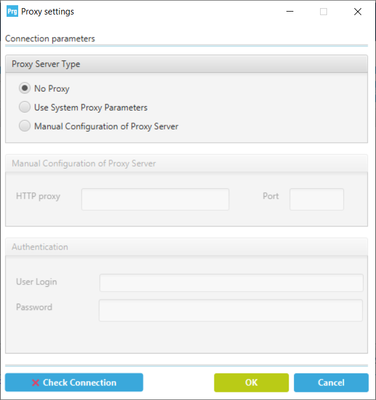

- A screenshot after you click on "Help->Proxy settings->Check connection".
Thanks in advance,
Aziz

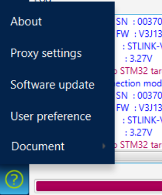

From Help->About:
STM32CubeProgrammer v2.11.0
After clicking Check Connection:
(Nothing about the window changes; the X was already present in the Check Connection button and remains present).

Having the same pop up always. Ubuntu 23.10 cube programmer 2.14.0. Not being behind any proxy. Why turning of this messages if it's correct that the connection is dead  ? Update does not work . always a connection error.
Downloaded version 2.16 and update function now works.
helioz
I experienced the same issue with V2.13.
Upgrading to V2.16 fixed it.
