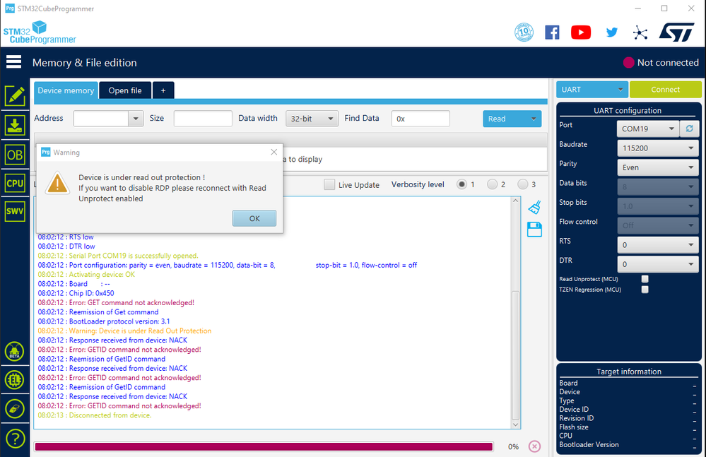

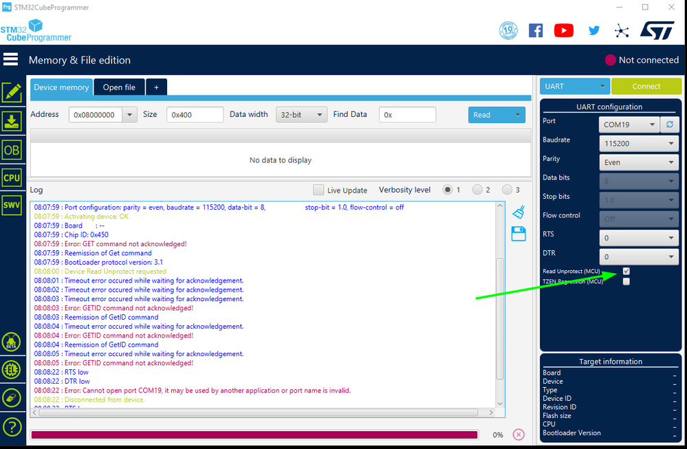

I ran system bootloader, I can perform the bootloader process using the STM32CubeProgrammer software via USART. But what I want is to run the bootloader software over TCP or UDP using the USART protocol. Because my UART2 line is connected to a TCP converter.
I wrote a piece of code using Python, but it's very slow and disconnects after a while. Is it possible to enable STM32CubeProgrammer to communicate with UART protocol over TCP?
Softwareally, I used TCP to Uart converters, but STM32CubeRogrammer is getting a time delay error.
My system is as follows;

I don't think it can be considered a problem in CubeProgrammer side :smiling_face_with_smiling_eyes: .The standard use case (where latency is "normal" ) is working fine.
However I will raise your request internally to enhance the tool to support such use case with high data transfer latency between host and device.
CubeProgrammer team will debug further and see how they can address this modification.
I will keep you posted for any updates.

I connect the STM32CubeProgrammer software to a virtual port on the computer, this virtual port is connected to another virtual port which turns into TCP. I expect this to work. But I am getting errors on STM32CubeProgrammer.
