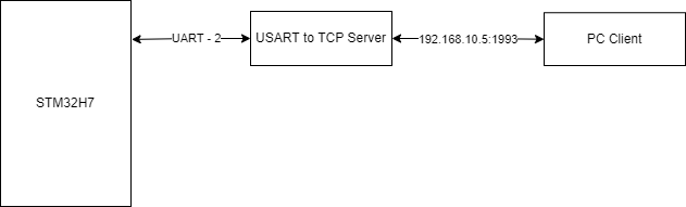

I ran system bootloader, I can perform the bootloader process using the STM32CubeProgrammer software via USART. But what I want is to run the bootloader software over TCP or UDP using the USART protocol. Because my UART2 line is connected to a TCP converter.
I wrote a piece of code using Python, but it's very slow and disconnects after a while. Is it possible to enable STM32CubeProgrammer to communicate with UART protocol over TCP?
Softwareally, I used TCP to Uart converters, but STM32CubeRogrammer is getting a time delay error.
My system is as follows;

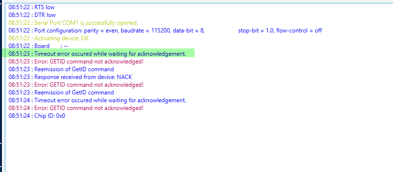

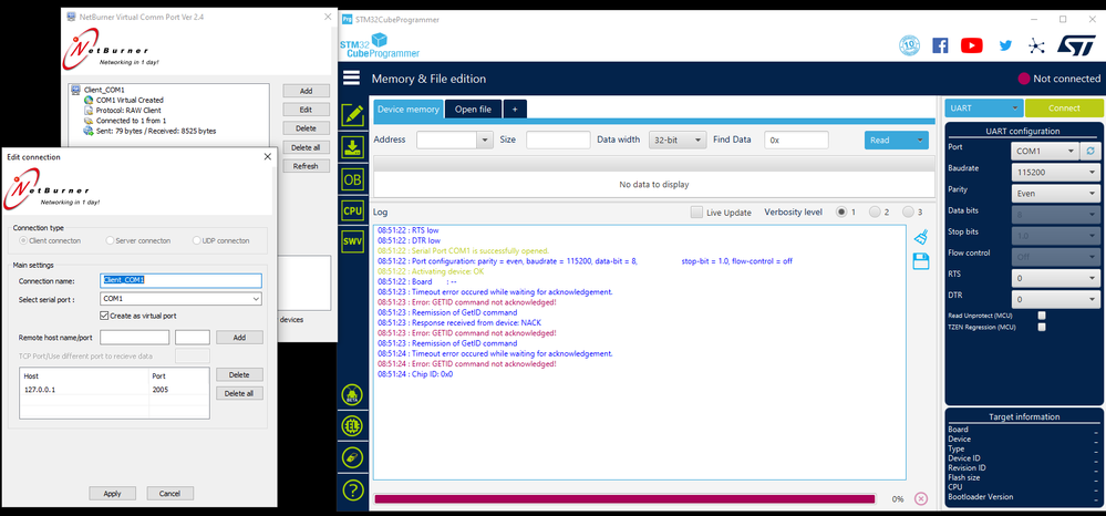

‎2022-03-28 10:59 PM
I was try NetBurner Virtual Comm Port Ver 2.4, however, this gave a time delay error (Timeout) like my python script.
I need more long time for waiting for acknowledgement.
How can I increase the acknowledgement wait time?

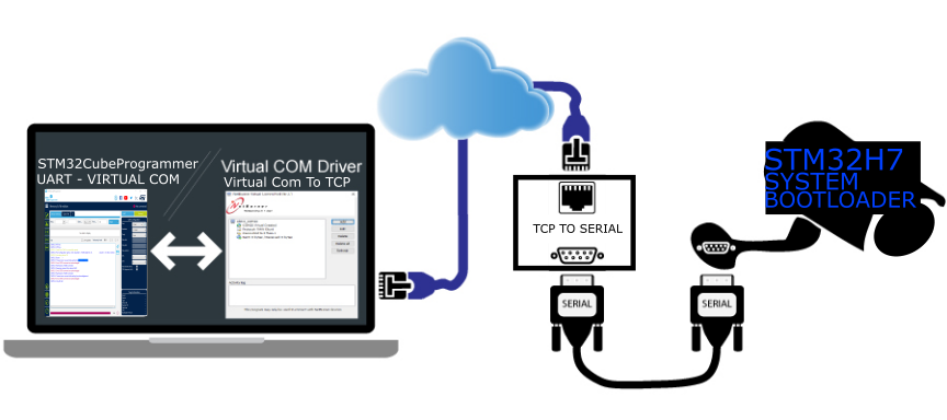

My System

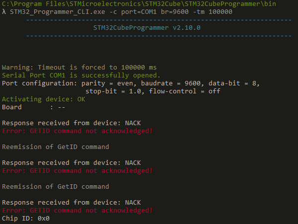

‎2022-03-30 2:10 AM
I propose to test this, hope it resolves the issue :
- There is an option to increase the timeout using CLI :tm , we can set vlaue in ms .
STM32_Programmer_CLI.exe -c port=COM36 -tm 100000
STM32CubeProgrammer v2.10.0-RC2
Warning: Timeout is forced to 100000 ms
Serial Port COM36 is successfully opened.
- Did you already try to decrease the Bauderate value?
Can you please test it and tell me if it is OK ?
Houda
‎2022-03-30 5:32 AM
Hi @Houda GHABRI​
I'm sorry for the late reply,
Timeout error persistsi, this method is not ok
I'm working over TCP;
I do decrease the Bauderate value over, there is a timeout error (Over TCP)
İf direct connect to system bootloader (STM32H7 UART-2)

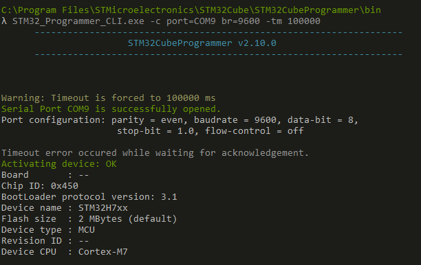

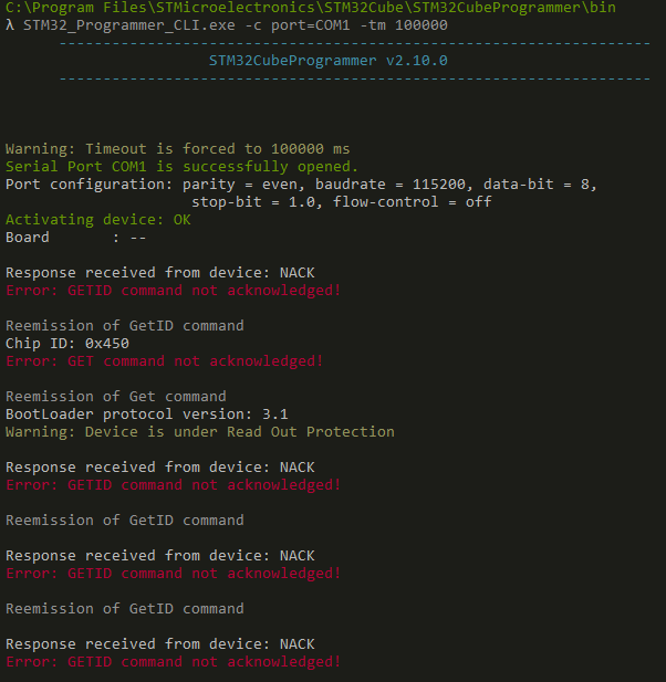

‎2022-03-30 8:02 AM
STM32CubeProgrammer is designed to operate in an environment where the host and device are close and ideally directly connected. Clearly not expected to work with such latency.
So CubeProgrammer cannot help in this case, what I can suggest is to try to use STM32 Flash loader demonstrator tool available here ,may be it is more tolerant about latency.
