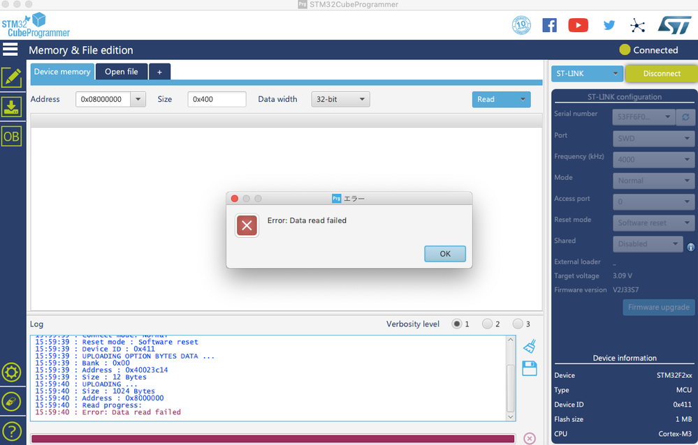

I am using a board equipped with STM32F205 VCT7.
https://www.hibot.co.jp/ecommerce/prod-detail/16
During "Connect" with STM32CubeProgrammer, I accidentally dropped the main power of the board.
Since then, such a screen came out when "Connect" was made.
I had a problem like this before, I sent the board to the company that made this board and inquired.
The company replied that "RDP was at Level 1, so I changed it to Level 0 with ST-LINK / V2 Utility."

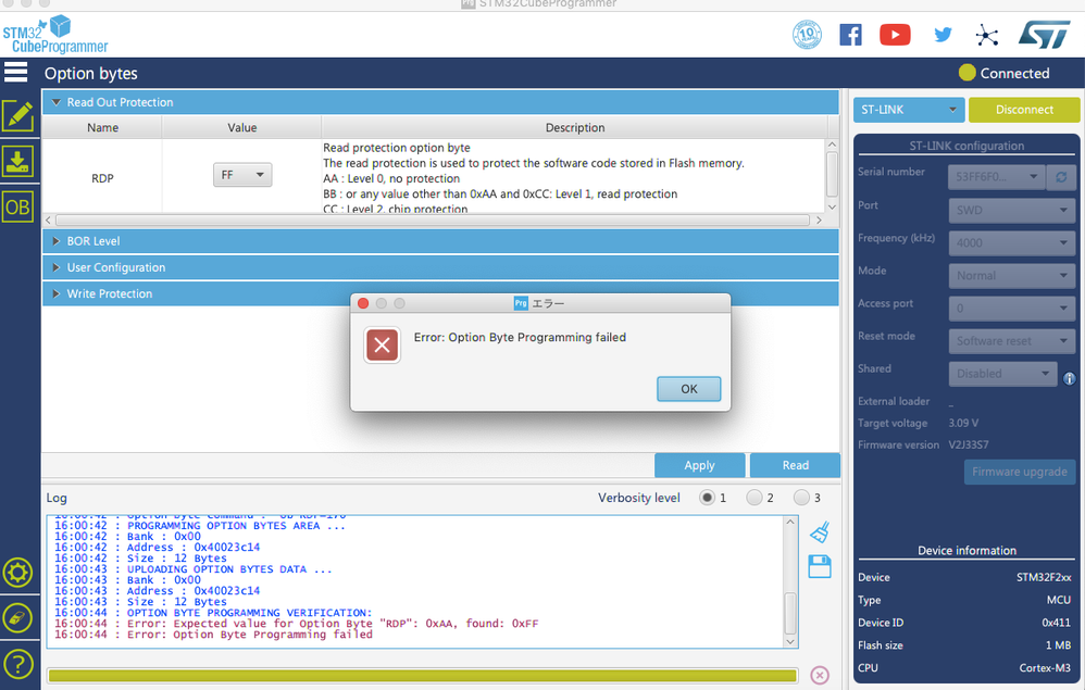

I think this problem can be solved by changing RDP, and when I try to change RDP from "Option Byte", such a screen appears.
Why is RDP not changeable even though "Connect" is done?
Help me.

Try setting Mode to Connect Under Reset.
kazu_robot
Thank you for your reply.
This problem was caused by my mistake.
I used to supply power using a regulated power supply.
In some cases, a voltage lower than that required to drive the board is supplied.
This caused such a problem.
Thank you for thinking together.
