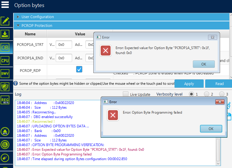

Rena Z.
0693W00000Y8ZH4QAN.pngsame issue with STM32CubeProgrammer.

Here is an additional log where I have increased the verbosity level to 3:
 07:03:34:480 : r ap 0 @0x1FFF6FFE 0x00000004 bytes Data 0xFFFF00B2
 07:03:35:575 : r ap 0 @0x1FFF6FFE 0x00000004 bytes Data 0xFFFF00B2
 07:03:35:724 : Option byte command : -ob PCROP_RDP=1 PCROP1A_STRT=0xff

 07:03:42:156 : Error: Expected value for Option Byte "PCROP1A_STRT": 0xFF, found: 0x0
 07:03:42:213 : Error: Option Byte Programming failed

Rena Z.
What a pitty! All the nice CLI options to restore the option bytes are only available for STM32WL devices ???
STM32_Programmer_CLI.exe -c port=SWD -ob unlockchip
            STM32CubeProgrammer v2.12.0
ST-LINK SN : xxxxxxxxxxxxxxxxxxxxxxx
ST-LINK FW : V2J40M27
Board    : NUCLEO-G071RB
Voltage   : 3.21V
SWD freq  : 4000 KHz
Connect mode: Normal
Reset mode : Software reset
Device ID  : 0x460
Revision ID : Rev B
Device name : STM32G07x/STM32G08x
Flash size : 128 KBytes
Device type : MCU
Device CPU : Cortex-M0+
BL Version : 0xB2
Debug in Low Power mode enabled
UPLOADING OPTION BYTES DATA ...
 Bank     : 0x00
 Address    : 0x40022020
██████████████████████████████████████████████████ 100%
Error: Only STM32WL devices are supported.
Error: Fail to unlock chip
STM32_Programmer_CLI.exe -c port=SWD -setdefaultob
Voltage   : 3.21V
SWD freq  : 4000 KHz
Device ID  : 0x460
Revision ID : Rev B
Device type : MCU
BL Version : 0xB2
 Set default OB for STM32WL

Hello @Rena Z.​ ,
To reset the PCROP1 you need also to perform a transition from RDP1 to RDP0.
So it means:
1-Check PCROP_RDP and put RDP=BB (level 1 reed protection)
2-Put RDP=AA (level 0, no protection)
3- Your PCROP registers have the default values.
Just be careful to not put the circuit as RDP level 2 otherwise the circuit will be blocked for ever.
Best regards,
Simon
