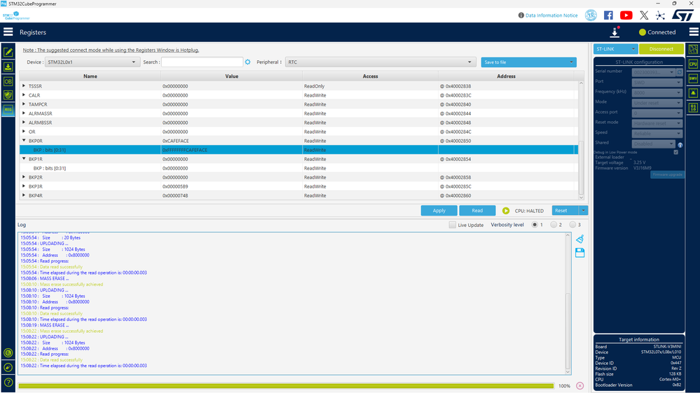

Could I erase rtc backup registers with STM32CubeProgrammer ?
waclawek.jan
... and, to be able to write into PWR registers, you have to set RCC_APB1ENR.PWREN first... :)

Yes, it is possible, but not via the standard mass erase in STM32CubeProgrammer.
For STM32L010/L07x/L08x you have two practical options:
  1. Directly in STM32CubeProgrammer
    • Connect in Hotplug/Halt mode
    • Open Registers → RTC
    • Manually write 0x00000000 (or any value) to BKP0R, BKP1R, etc., then Apply.

I try your suggestion via cubeprogrammer but I can't delete rtc bkp register. Please, check my video.
waclawek.jan
I don't use CubeProgrammer, but I believe you still need to enable the backup-domain access by setting PWR_CR.DBP before trying to overwrite the backup registers.
I try that PWR_CR.DBP register set firstly, still I can't delete. I guess I can't write to register via cubeprogrammer.
waclawek.jan
Thank you, That is worked.
