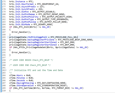

I am using MXCube for STM32U5A5VJ. I have enabled the RTC, and cube generates the following Init Function. In this way, everytime I restart the controller, the RTC date is gonna be overwritten. In practice, I would like to have the bracket at line 9 down in line 21. Thank you for your support.
Best Regards,
Gianmarco Cerutti
void MX_RTC_Init(void)
  /** Initialize RTC and set the Time and Date
  if(LL_RTC_BKP_GetRegister(RTC,LL_RTC_BKP_DR0) != 0x32F2){
    LL_RTC_BKP_SetRegister(RTC,LL_RTC_BKP_DR0,0x32F2);
  RTC_TimeStruct.Hours = 0x0;
  RTC_TimeStruct.Minutes = 0x0;
  RTC_TimeStruct.Seconds = 0x0;
  LL_RTC_TIME_Init(RTC, LL_RTC_FORMAT_BCD, &RTC_TimeStruct);
  RTC_DateStruct.WeekDay = LL_RTC_WEEKDAY_MONDAY;
  RTC_DateStruct.Month = LL_RTC_MONTH_FEBRUARY;
  RTC_DateStruct.Day = 0x11;
  RTC_DateStruct.Year = 0x25;
  LL_RTC_DATE_Init(RTC, LL_RTC_FORMAT_BCD, &RTC_DateStruct);

CubeMX will overwrite any changes you make outside the /* USER CODE BEGIN ... */ and /* USER CODE END ... */ blocks.
Try to put your code in the user section.

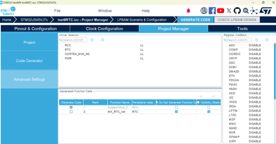

Hello @gianmarco.cerutti
As a workaround, copy and paste the MX_RTC_Init function into the user code section and make the required modifications.
Then, go back to CubeMX and untick the "Generate code" option for MX_RTC_Init.
This way, CubeMX will not generate the MX_RTC_Init function, and you will already have the customized function with your modifications.
Remember to call your modified MX_RTC_Init function in the main function to ensure the RTC is properly initialized.
