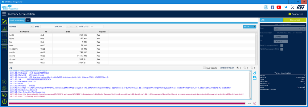

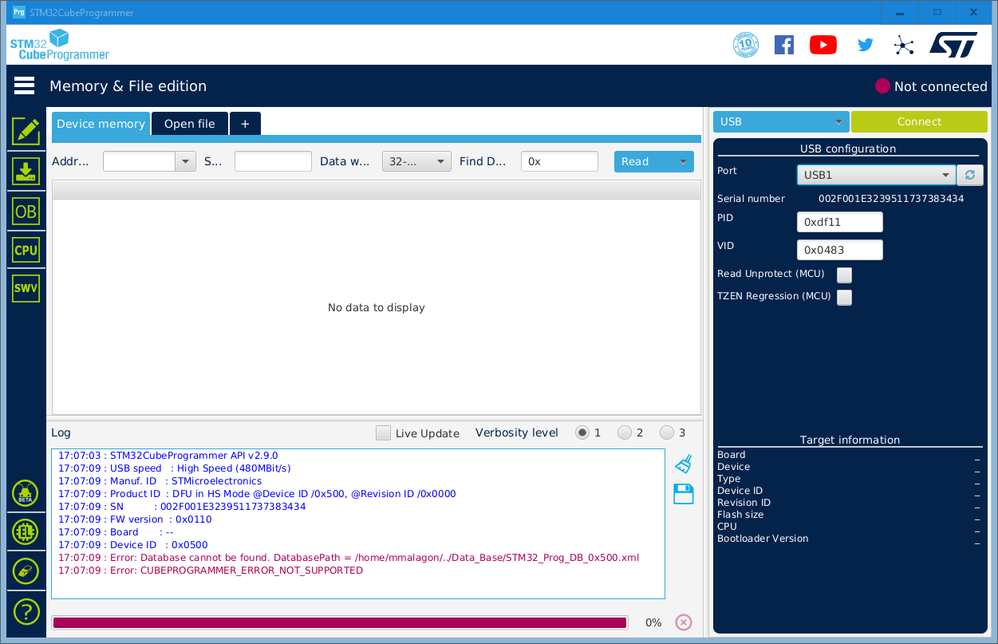

I just installed the CubeProgrammer and I'm following the Populate the target and boot the image guide. When I get to section 1.1.1.1.2.6 Populate the SDCard and click "Connect" I get this error:

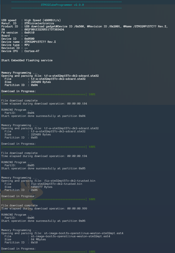

sudo /opt/st/stm32cubeprgrammer_2.9.0/bin/STM32_Programmer_CLI -c port=usb1 -w flashlayout_st-image-weston/trusted/FlashLayout_sdcard_stm32mp157c-dk2-trusted.tsv
Everything works perfectly fine. I get this:

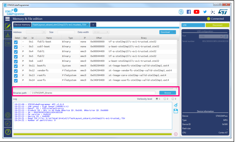

It seems that binary path is not filled with correct path, that's why CubeProgrammer still searching for an old path.
You need to give the path of binaries used as shown in screenshot below :
Can you please try and tell me if the issue is resolved?

I have to run it as superuser because if I don't, then neither the CLI nor the GUI can see the USB.
Yeah, that database is not stored at /home that is where I'm starting the GUI. So, it seems that I need to go to <install dir>/bin every time I need to run it? Isn't adding the bin directory to the PATH supposed to avoid this?
2022-03-02 11:55 AM
I have to launch the GUI from the command line with sudo, otherwise, it won't see the USB port.

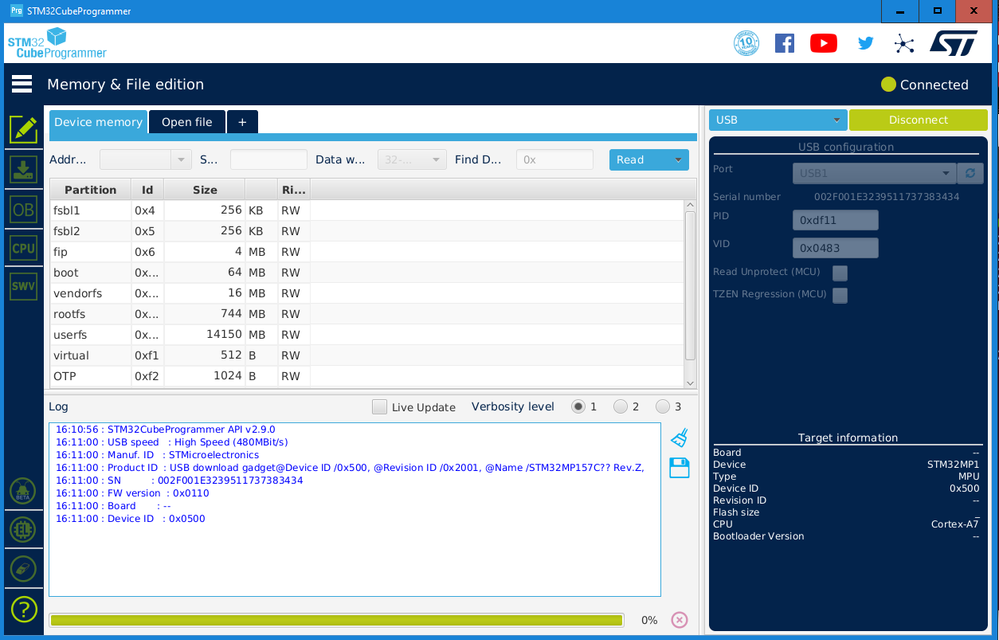

I just realized that if I go to <install_dir>/bin and run the GUI (<install_dir>/bin $ sudo ./STM32CubeProgrammer) from there then I don't get that error.
But now it is complaining about not finding the file I'm choosing. I don't know why it is changing the path. It says there in the blue message that is read the file
/home/mmalagon/STM32MPU_workspace/STM32MP15-Ecosystem-v3.1.0/Starter-Package/stm32mp1-openstlinux-5.10-dunfell-mp1-21-11-17/images/stm32mp1/flashlayout_st-image-weston/trusted/FlashLayout_sdcard_stm32mp157c-dk2-trusted.tsv
So I don't know why it is complaining about not finding this file:
Error: File does not exist: /home/mmalagon/STM32MPU_workspace/STM32MP15-Ecosystem-v3.1.0/Starter-Package/stm32mp1-openstlinux-5.10-dunfell-mp1-21-11-17/images/stm32mp1/flashlayout_st-image-weston/trusted/arm-trusted-firmware/tf-a-stm32mp157c-dk2-usb.stm32
Why is it trying to use that file, that is not the one I have specified.
Houda
2022-03-14 3:53 PM
@Houda GHABRI Thanks for helping.
Yes, correcting the path solves the issue. Now it works ok.
