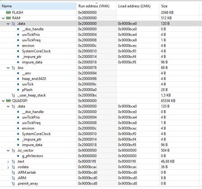

Hello all,
I modified my .ld file as:
MEMORY
 RAM   (xrw)   : ORIGIN = 0x20000000,   LENGTH = 512K
 FLASH   (rx)   : ORIGIN = 0x8000000,   LENGTH = 2048K
 QUADSPI (rx) : ORIGIN = 0x90000000, LENGTH = 64M (added line)
And I replaced  FLASH with  QUADSPI in order to load all to external flash.
I copied MX25L512G_STM32F769I-DISCO.stldr file to external loader folder of CubeMXIDE.
I modified system_stm32f7xx.c to set 0x90000000L offset:
  /* Configure the Vector Table location add offset address ------------------*/
#ifdef VECT_TAB_SRAM
  SCB->VTOR = RAMDTCM_BASE | VECT_TAB_OFFSET; /* Vector Table Relocation in Internal SRAM */
#else
  //SCB->VTOR = FLASH_BASE | VECT_TAB_OFFSET; /* Vector Table Relocation in Internal FLASH */
  SCB->VTOR = 0x90000000L | VECT_TAB_OFFSET; /* Vector Table Relocation in Internal FLASH */
#endif
When I debug the program with STM32CubeIDE
with external loader (MX25L512G_STM32F769I-DISCO, 0x90000000, NOR_FLASH, MX25L512G_STM32F769I-DISCO.stldr) my program reaches 0x90000000 and executes the code.
When I reset program (e.g. by button) or try to download program with STM32 ST-LINK Utility or STM32CubeProg... my program does not start.
https://github.com/rudoq32/STM32-QSPI.git
Do you have any useful hints for me?
Thank you
Rudo

You'd need code running from internal flash to stand-up the external interface before the processor can access it. That code would then need to transfer control to the image in external memory.
The CPU will start from 0x00000000, and thus your code in FLASH 0x08000000 that gets mapped their initially.

I'm saying the board/chip unique aspects of the external memory aren't magically known to the MCU, you must configure them using code running ​inside the MCU first. You need to provide this code.

The stuff bringing up the QSPI interface.​

This is a Horse+Cart scenario, you've built a Cart, now you have to put a Horse in front of it.
The Horse would be a small loader app, that you might want to build separately, that resides at 0x08000000. It contains the code to set up the clocks, set up the QSPI (using the BSP code for the F769I-DISCO), and then transfers control to your image at 0x90000000. Your main app should then avoid messing with the clocks or QSPI interface again.
Perhaps look at some of the IAP examples where the boot loader and application sections are split into two pieces.

Simply put: You can't at all. Your firmware has to consist of two parts: One resides in internal flash, and starts after reset by fetching stack pointer and start address from reset vector at 0x0800000. By this time, the CPU does know precisely NOTHING about QPSI, that is the QSPI memory is totally inaccessible. The code in the internal flash has to configure the QSPI interface, maybe even configure the external flash chip for proper operation (e.g. QPI mode vs. SPI mode, 4- vs. 3-byte addresses, drive impendance). Then QSPI has to be reconfigured for memory mapped mode (still by code in internal flash). Only then the external flash is mapped into the address space of the CPU and hence visible by the CPU. After that, the internal flash and the QSPI are almost indistinguishable by the CPU, so code execution can be transferred at will between internal and external flash.

I found QSPI_PreInitConfig example. It is not exactly what I need, but it seems that they initialize QSPI interface and then execute a code from 0x90000000. The readme contains text:
How to configure the QSPI IP in order to have access to external memory just after reset.
This example describes how to execute a part of the code from a QSPI memory. To do this,
a section is created where the function is stored.
The QSPI is configured in memory-mapped mode before to call main() function and QSPI memory
is then available after the reset.
