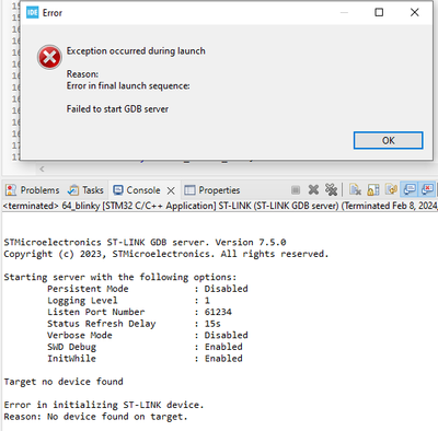

From stm32cubeIDE:

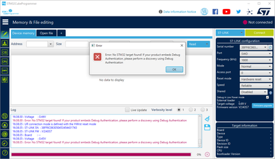

From stm32cubeProgrammer:

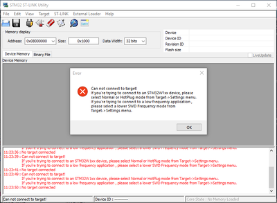

From stm32 st-link utility:
I've tried different frequencies and modes but I still get the same errors.

The nucleo board has an onboard st-link. You don't need an external programmer for it. Just need to connect CN1 with a USB cable to your PC.
Connecting what to what? The Nucleo is hard wired.
Check the jumpers for SWDIO / SWCLK connect to the local target.
Then perhaps ponder why the voltage isn't reading 3 - 3.3V
