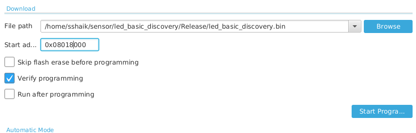

I am using LED blink firmware generated using CUBE-MX by Disabling all the modes and Clearing the pinouts.
I flashed one firmware in the bank-1 (0x08000000) and
second firmware(with few changes the way the led blinks) flashed into the bank-2 (0x08018000) using the stm32 programmer.
First I writing the firmware-2 into bank-2 like this.

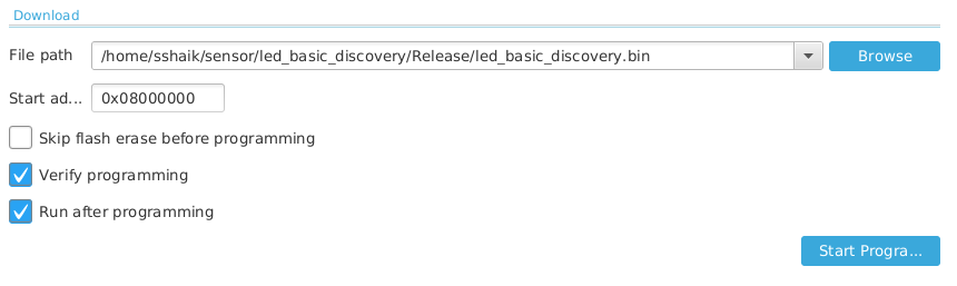

Next I am flashing the firmware-1 in the bank-1 and running .
0693W00000BbKpCQAV.pngI kept the bank switch logic in firmware-1.
My main() fun will look like this:

Leds I kept for the debug. The code is executing till the leds BLUE and RED glowing together and fading (line 36) after that I am not able to see the leds. So I am thinking it got stuck at
SET_BIT(SYSCFG->CFGR1, SYSCFG_CFGR1_UFB);
Is this aporach is right? Anything else is required? Please suggest?
