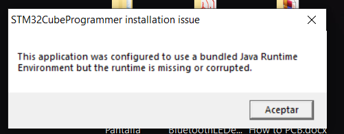

Hi! I have a problem with Java too. I have seen that the Cube Programmer Zip has his own jre, but when I try to install ir I get the following message. Do you Know what could be happening here? Thanks.
What are you using to unpack the .ZIP?
Do you unpack to a folder or do you try to use in situ via the Shell Extensions?
They migrated from the Oracle JRE, perhaps it is missing some Microsoft VC Runtime / Redistributables?
Encountered similar errors on fresh Win10 installs and apps needing MSVC120 and MSVC140
Sorry for the .delay. I unpack the zip in my desktop with winrar. I have tried to put into a folder all the stuff but nothing.
I don't understand why MSVC is needed if the program is developed in Java, but i have tried to reinstall the lastest packeet of redistributables and nothing change.
Thanks a lot for your time.
CGali.2
I have no problem when I install 32 bits version.

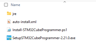

I've had this issue automating the installation process for an application that calls cube programmer.
It might not be your exact problem but I'm sure it could help somebody else searching this error.
I basically use the "1.2.8 Automatic/Silent installation mode" from the user manual. So I have a script that checks if the version is already installed and skip it if so because the base installer doesn't do that. The script is calling ".\jre\bin\java.exe" -jar "stm_cp_installer_path.exe" "auto_installer_path.xml".
If the script is not in the same path as the installer files, I get the "IzPackException":
If I put my script in the same folder than the "jre" folder,  auto-install.xml and installer.exe, it does work:
I've tried using absolute path everywhere, but this is the only setup that work.
My best guess is that, a step in the installer is using a relative path (when the CMD windows popups during installation).
Hope it will help someone!
