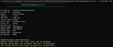

I am working with a NUCLEO-WB15CC, and it seems that I can't read or write anymore. When I connect via ST-Link in STM32CubeProgrammer (v2.14.0) I just get
Error: Data read failed
When I try to read registers, I get the same error.
I also can't erase the chip:
Error: Mass erase operation failed.Please verify flash protection
RDP option byte is AA, so that can't be the problem.
For write protection, I don't really remember what the default values was, but they are: 0xff, 0x0, 0xff, 0x0,
I can still see target information in Programmer but nothing else seems to work, have I bricked the chip?
Edit: I noticed I also can't read registers via the CLI, so maybe it's not a bug in STM32CubeProgrammer.
This is the command I used:
STM32_Programmer_CLI.exe" -c port=SWD -r32 0x08000000 0x4
Which results in
Error: failed to read the requested memory content
Read protection seems to be disabled:

tester
I "fixed" this by running this command to reset the board to factory settings:
STM32_Programmer_CLI.exe -c port=SWD reset=HWrst -w32 0x5800040c 0x00008000
