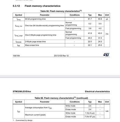

Dear @DWalk.3 ,
Please let us know the status with 64-bits .
For this product STM32WL - https://www.st.com/resource/en/datasheet/stm32wle5c8.pdf#page96
Flash programming is only by 64-bits at a time. On other series it can be 32-bits .
hope it helps you
Regards,
STOne-32

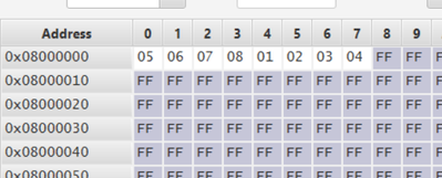

64-bit works with the following caveat: the high and low 32-bit words seem to be swapped. For example, if I do:
> stm32_programmer_cli -c port=SWD mode=NORMAL reset=HWrst -q -w64 0x08000000 0x0807060504030201
When I look at the memory file, I see the following:
So the endianness seems to be "middle"; it consists of two consecutive little endian 32-bit words.
