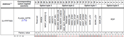

BOR level description is confusing
FArdi.1
Using latest STM32CubeProgrammer v2.15.0
Register name and description don't match (rising register, but falling description, and vice versa).
Which one is correct?

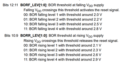

Rising voltage is higher than falling voltage. Description on the left is correct.
The reference manual is the best reference source.
See this post, STM32CubeProgrammer might be writing them to the wrong locations anyway. Unclear.
https://community.st.com/t5/stm32cubeprogrammer-mcus/stm32cubeprogrammer-2-10-0-released/m-p/134440/highlight/true#M1675

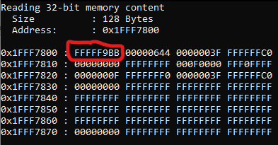

Thanks for the answer & the link to old issue.
At least for now the address location is correct for -ob BOR_EN=0x1 BORF_LEV=0x3 BORR_LEV=0x0
Only descriptions inside GUI need to be swapped.

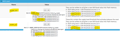

Description is unchanged with new v2.16.0. Still wrong, not match with Reference Manual.
But the release history said otherwise. See attached.
