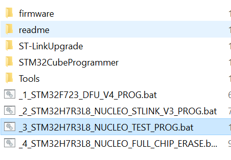

EXUE.2
yes, we used STM32 Cube Programmer as a production tool in our develop board production in factory. but not use it's GUI format, we build some .bat script to implement the programming or erase operation.
one programming .bat example like below "_3_STM32H7R3L8_NUCLEO_TEST_PROG.bat"
0693W00000VOtEFQA1.png@echo *** MB1737 test programming ***
STM32CubeProgrammer\bin\STM32_Programmer_CLI.exe -c port=SWD freq=8000 -d firmware\STM32H7R3L8-NUCLEO_tst_V1.0.2.hex -v
goto start
