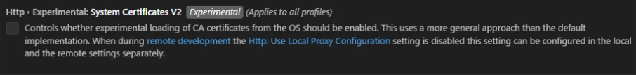

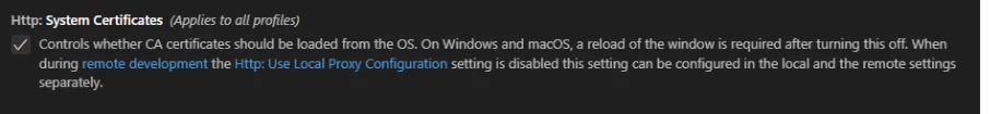

1. Certificate configuration
  1. The manual configuration (Windows)

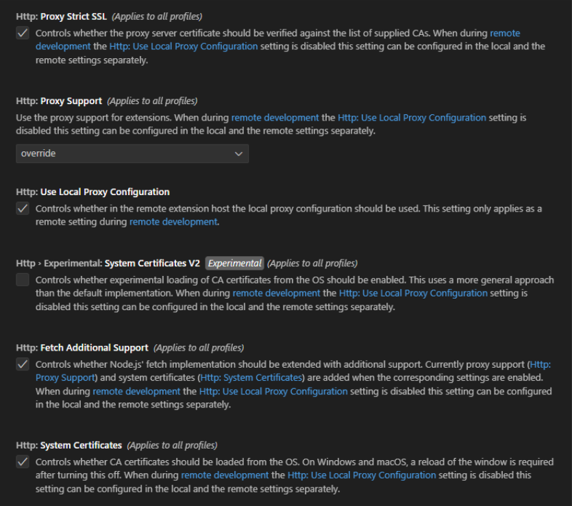

    • Ensure that you have this configuration in your settings:
      • System certificate V2 unchecked
      • System certificate checked

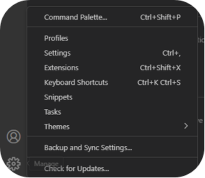

    • In the command palette, launch "STM32Cube: check proxy settings" command to ensure that you have access.

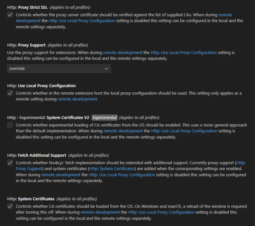

  2. Assuming your corporate self-signed certification is trusted by your operating system (Windows).
    You can now configure Visual Studio Code to use the operating system certification. Launch Visual Studio Code, go to File → Preferences → Settings → Search for "certificates" and check the box for Http → "Experimental: System Certificates V2."
    IT Controls whether experimental loading of CA certificates from the OS should be enabled
3. Import the certificate to your operating system (Windows.) Make sure that the certificates are imported into your OS and trusted in the system category. Then, go into Visual Studio Code settings → Application, Proxy, and uncheck the "System certificates" option. Restart Visual Studio Code and recheck it. Restart Visual Studio Code once again, and it should work.

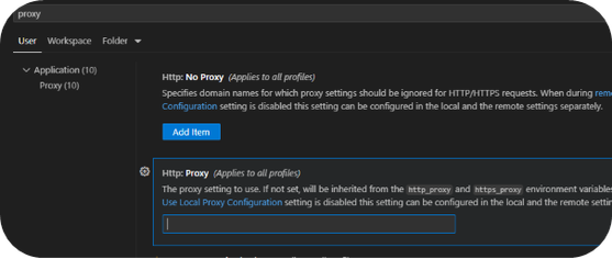

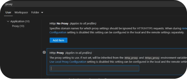

2. Proxy configuration
  •  Open the VS Code settings and type proxy in the search bar.
  • Put your proxy in this format "http://Proxy-address:port" (Visual Studio Code prompts you to provide your login and password.)
  • For security reasons, we do not use the "http://user:psw@Proxy-address:port" format for the proxy, but if you have to, special characters must be transformed to hex format. For example, a # is written as %25.

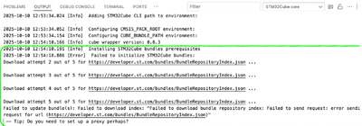

3. Extension proxy configuration
Our extensions check the connection to the bundle registry at VS Code startup.
In case of connection issues, a notification is displayed:
Choose to set your credentials with "Proxy Credentials…" option.
  • Set the proxy username and press Enter:
  • Set the proxy password and press Enter:
  • Ensure that the connection succeeds:
  • Continue “STM32CubeIDE for VS Code” setup by installing the required bundles:
Note 1: Proxy credentials can be erased with this VS Code command.
Note 2: A connection check can be started at any time with this VS Code command.

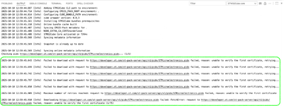

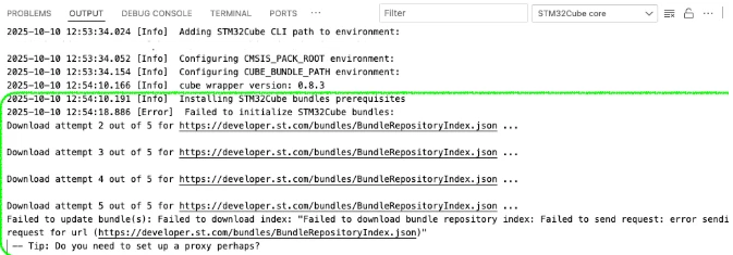

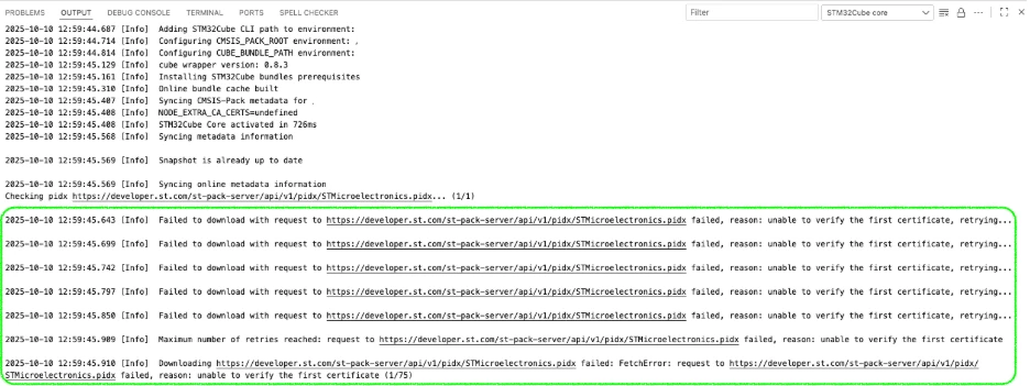

4. Troubleshooting SSL
In most corporate situations, setting a proxy URL and its credentials is not enough. The proxy uses a nonpublic CA certificate between your computer and it.
This leads to a situation where tools cannot ensure that the https connection is valid, with these usual errors in VS Code:
Marketplace:
“STM32Cube core” output channel:
To fix it, you must ensure that:
  1. The proxy CA certificates are configured into your system trust-store. This is usually provided by your local IT department.
  2. The NODE_EXTRA_CA_CERTS environment variable is defined system wide and points to the proxy CA certificates bundle file (request your local IT to share this file with you.)
