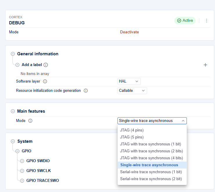

This issue has already been reported internally under ticket number CDM0060745, fixed and will be available in the next release. For now, you can use the following option, the only downside is the extra trace signal is pin locked(which will be fixed):
