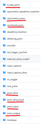

I can propose to look at the examples provided in CubeC5 package:
https://github.com/STMicroelectronics/STM32CubeC5/tree/main/examples/hal/tim
I don't think there is a step by step guide treating PWM for the moment. This knowledge base is about How to use TIM with STM32CubeMX2 but unfortunately treats the case of a basic time base.
