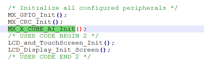

I've successfully generated a project with X-CUBE-AI. I searched for some examples on the internet and I've found that MX_X_CUBE_AI_Init is missing from my project. Why this function call is missing? I've the latest CubeMX.

Is the function created? Share your IOC, probably an unchecked box in the initialization settings.
I found it. I have set 'Application template' option in the X-CUBE-AI config however this option is not documented.
