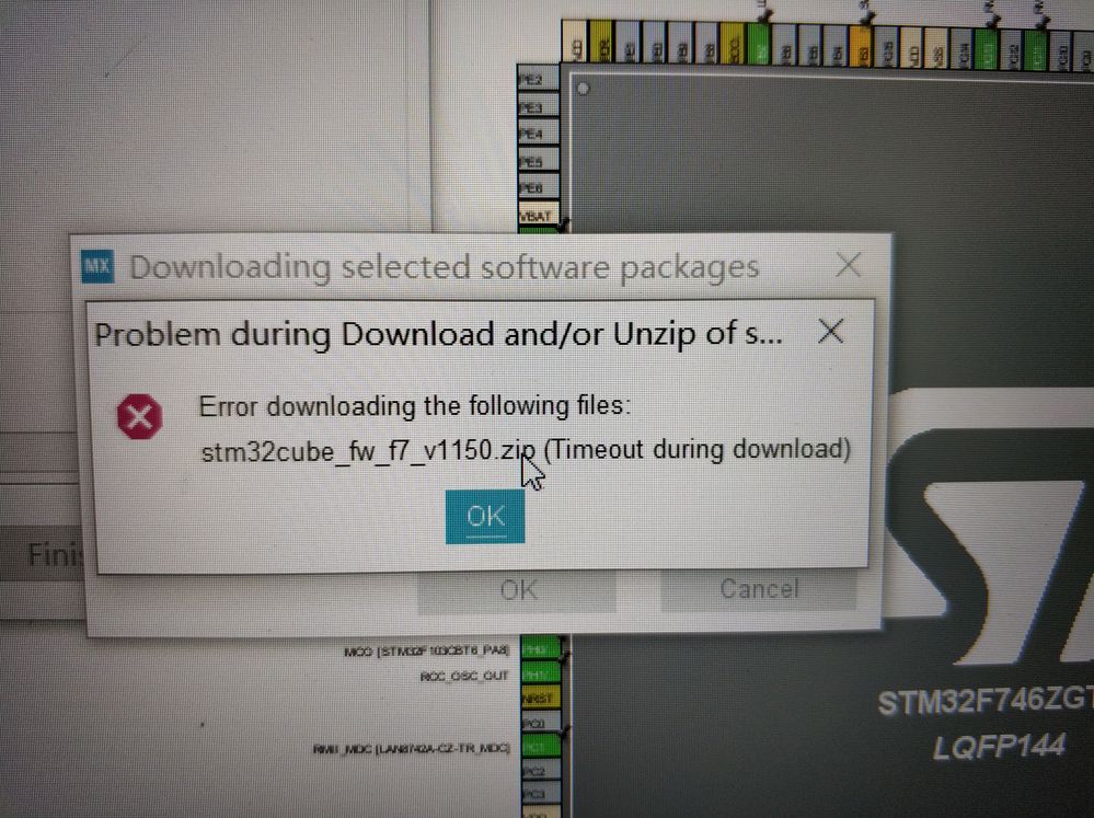

why i cannot generation code when i want to establish a project??

Because apparently your internet connection can't sustain the download of the CubeF7 package?
You can download CubeF7 directly, and install "From Local" within CubeMX
https://www.st.com/en/embedded-software/stm32cubef7.html
Make sure you have the repository directory set up, and that it is accessible. Check for interference from AV software.

I have downloaded the F7 package?There are so many files,how can I import what i need to my own project?
