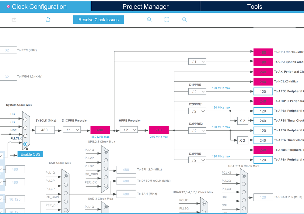

Why does the updated version of Cube Mx and ide give an error in the clock section?
Mcu => Stm32H743 and Stm32H750
ST, you have a bug ??

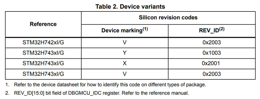

For the STM32H743 , we have 3 revision ( Screenshot from Eratta sheet)
Use silicon revision V devices to reach a maximum frequency of 480 MHz.
