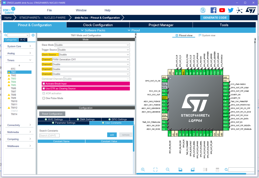

Hi Kholoud,
Here it is.
When the .ioc is opened the first time in the Eclipse session the user constants are available, however, if the .ioc is closed then reopened are not available anymore.
The code generation however "sees" them: in this project the generated code uses the constants used in the DCTool in the timers init functions.
Cheers,
Adriano

Hi Khouloud,
With MX standalone the problem persists.
Steps:
- open the attached .ioc -> constants OK
- start a new project, choose MCU
- reopen original .ioc -> constants not visible, see screenshot:
Cheers,
Adriano

Hi @Adriano Melis​
Yes, now issue reproduced (thanks for sharing steps, the problem appears at this level: start a new project, choose MCU, without saving the project).
Issue will be fixed, thanks for your contribution.
Khouloud

‎2021-08-19 3:05 AM
Hello @Adriano Melis​ ,
I'm back again to inform you that issue is now fixed, you can use the latest CubeMX version available on site :)
Khouloud
