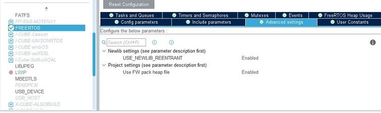

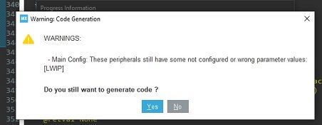

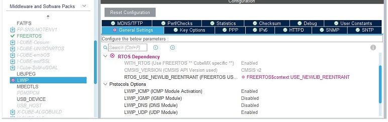

After enabling USE_NEWLIB_REENTRANT in FREERTOS (pic.1) I get error notification in LWIP (pic.2) and also after I try to compile this settings (pic3). This error info disappear when I manually put in 1 in the field
with red error text (pic.2 > RTOS Dependency).
Should there be a number 1 or some other number and is it some kind of bug? (CubeIDE Version: 1.12.1, CubeMX 6.8.1)
