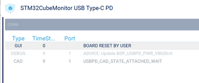

For my understanding: The STM32CubeMonitor USB-PD has two views: the first page where detected boards shall be shown and a second trace view after selecting a COM port in the Select Tracer Port upper right corner. I´ve selected USART1 to TRACE Source. Hence a shall see anything on USART1 in the monitor?
Best regards,
Achim
‎2024-06-25 5:57 AM
Hi Pascal,
now I tried to build up a new project.
Once I get as Trace:
And now permanently ADVICE: Update_BSP_USBPD_PWR_VBUSGetVoltage
Achim

‎2024-06-25 7:04 AM
Hi Pascal,
indeed the voltage reading is missing in the automatic generated code! (I use TCPP package with CubeIDE)
Then Ive tried to generate the code with MX and then it works! I´ve to investigate further, but I suspect, that maybe CubeIDE is not working correctly with the TCPP package...
I´ve not already the 20V running, but I get a trace (see attachement) in the meanwhile :)
Best regards,
Achim
‎2024-06-25 7:16 AM
Hi Pascal,
indeed! It is a problem with CubeIDE for Code generation.
Now I cleaned all USBPD and TCPP parts in the project and generated everything with CubeMX - and: I´ve 20V :)
Attached the trace. Do you think everything is fine?
Thank´s a lot for your quick support!
Best regards,
Achim
