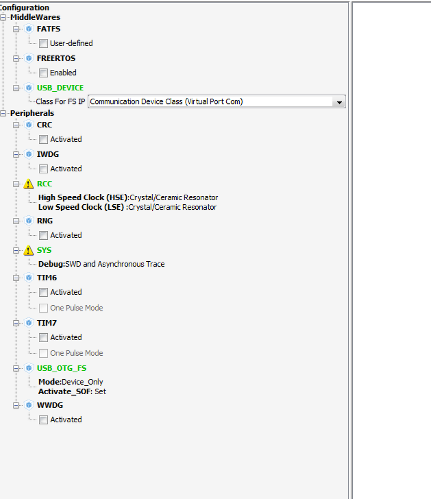

I am trying to get a USB CDC Device demo working on an STM32F4 Discovery board (with the STM32F407) with code from the STM32CubeMX generator application. The process has been murky at best, hopefully one of you can set me straight.
So far, I have configured the project in STM32CubeMX, exported the code, merged the src and inc files with my project template (to use arm gcc). Included in my project template is the CMSIS, HAL and USB driver libraries. Additionally, I have updated my Makefile to build all of the required files. Here is the entire project: https://github.com/thenatefisher/stm32cube-usb-cdc-device-demoAfter connecting both the mini and micro USB ports to my PC, I am able to build the application and load it to my device using openocd and arm-none-eabi-gdb. I can also run the application, but I do not see the device enumerate on my PC. I can verify this by performing an ls /dev/tty.usb* and I see no results. In addition, in the OSX System Information window, under USB, the virtual com device is not showing up. I am probably missing some very large steps here. Any pointers will be helpful. Thanks. #stm32cubemx #c #usb #discovery #cdc #vcp #stm32- Labels:

Tried with FS mode too. Here is a shot of my latest attempted.

There is a bug in the USB wakeup interrupt service routine generated by CubeMX for this application. It affects the F4 parts (OTG) but not F3 etc. Edit the file stm32f4xx_it.c that CubeMX generated and add the following line of code to the OTG_FS_WKUP_IRQHandler() routine:
void OTG_FS_WKUP_IRQHandler(void)
{ /* USER CODE BEGIN OTG_FS_WKUP_IRQn 0 */ __HAL_GPIO_EXTI_CLEAR_IT(EXTI_PR_PR18);/* USER CODE END OTG_FS_WKUP_IRQn 0 */
HAL_NVIC_ClearPendingIRQ(OTG_FS_WKUP_IRQn); HAL_PCD_IRQHandler(&hpcd_USB_OTG_FS); /* USER CODE BEGIN OTG_FS_WKUP_IRQn 1 *//* USER CODE END OTG_FS_WKUP_IRQn 1 */
} It fixed the problem for me. Hopefully they will fix it in the next version of the F4 package (It is in there, not in the base Cube itself).- Mark as New
