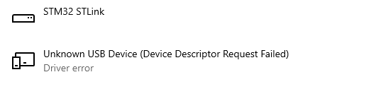

Unknown USB Device on stm32F429ZI device
Lucas213
Lot of people had this issue, nothing worked for me and I think it might be a newbie mistake.
I'm trying to communicate in USB between my PC (host) and a stm32f429ZI board (device).

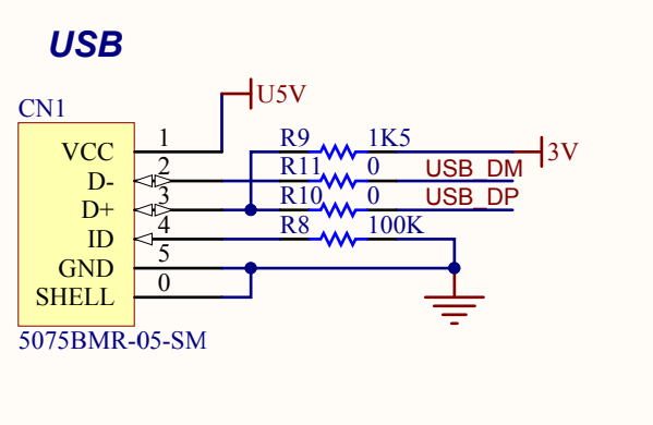

Here are the schematics for the USB pins of this board.
I measured:
VCC 5.1V
D- 0V
D+ 2.9V
ID 0V
GND 0V
I tried to activate the VBUS as well even if my power source is from the PC and that I get the 5V on VCC, no improvement

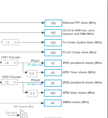

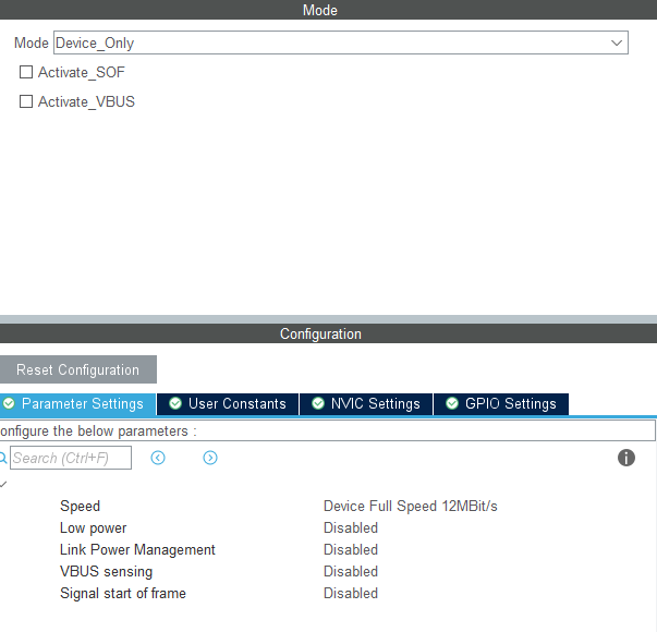

My STMcube settings and clock:
0693W00000QM3CDQA1.png0693W00000QM3CcQAL.pngUsb device is activated and set to Communication device class

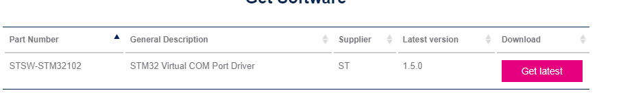

My windows driver is this one: 0693W00000QM3E9QAL.png

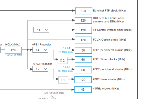

I changed the clock ouput to this and it works now. Really feels ****. I don't know how I could have known.

So some clocks too slow? There's perhaps notes in RM to avoid clock inversion and expectations. The PLL needs to be running for sure, along with solid 48 MHz. Things like SDIO have clock ratio expectations and PLL requirements, for sure.
