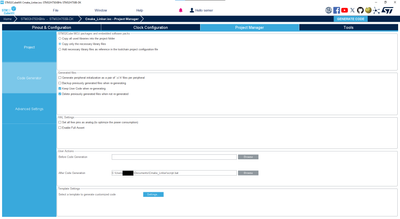

But everytime I use CubeMX regenerate the project, STM32H750XBHx_FLASH.ld will be recovered. My changes didn't save.
How can I save this modified STM32H750XBHx_FLASH.ld when CubeMX regenerates project?
Solved! Go to Solution.
‎2024-07-09 6:27 AM
Hello @Nobody233
In fact, this is a known behavior of STM32CubeMX and under investigation.
As a temporary solution I propose that you make modification on a back up linker file. Then use a script to copy it and replace the one imported by STM32CubeMX at each code generation.
The script could be executed using the "User action" feature in STM32CubeMX.
BR,
Semer.

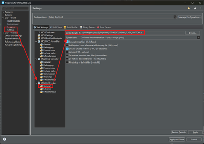

‎2024-07-09 7:07 AM
Or, as a alternative you can create a new file STM32H750XBHx_FLASH_CUSTOM.ld with the modifications you want in it. And use this one as the linker script in your project configuration :
Then on your next CubeMX generations, the STM32H750XBHx_FLASH.ld will be regenerate but not the STM32H750XBHx_FLASH_CUSTOM.ld which will still be the one used by your compiler.
‎2024-07-10 2:19 AM
Hi, @Semer CHERNI
Thanks for your reply.
Firstly, it could be work as your suggestion.
Secondly, I found another solution.
I found that "cmake\gcc-arm-none-eabi.cmake" and "CMakeLists.txt" will not be covered when CubeMX regenerates project. Then I modified this two files to use another .ld file. The STM32H750XBHx_FLASH.ld would still exist but not be used.
