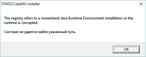

3. I tried to install the standalone version STM32CubeMX v4.20.0 - the installation was completed with an error:
(System can't find the specified path)
4. I tried to install the standalone version STM32CubeMX v4.20.0 on other PC - this is working,
there are no errors.
