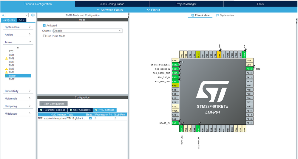

I'm trying to do a simple blinking led using interrupts but they never get fired.
I'm using 84 MHz clock frequency and the following options:

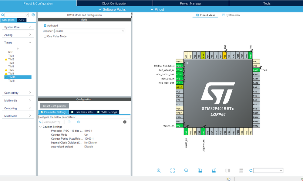

  htim10.Init.Prescaler = 8400-1;
  htim10.Init.CounterMode = TIM_COUNTERMODE_UP;
  htim10.Init.Period = 10000-1;
  htim10.Init.ClockDivision = TIM_CLOCKDIVISION_DIV1;
  htim10.Init.AutoReloadPreload = TIM_AUTORELOAD_PRELOAD_DISABLE;

As you can see, I'm just using HAL_TIM_Base_Start_IT(&htim10); and HAL_TIM_PeriodElpasedCallback(TIM_HandleTypeDef *htim) but timer never get fired on my STM32F401RE.
Am I doing something wrong?
By they way, it is not working in any timer :(
Thank you in advance!
UPDATE:
It seems that "HAL_TIM_PeriodElapsedCallback" in "stm32f4xx_hal_tim.c" is not choosing the one function in "main.c" but "__weak void HAL_TIM_PeriodElapsedCallback(TIM_HandleTypeDef *htim)" in that very same file. How can I fix this?

Check you have the NVIC configured and the IRQHandler side plumbing.
Check that it generated the code, rather than clicking buttons.
Thanks @Community member​ ,
I have made an update.
The Timer seems to be working since the LED toggle If I do this:
void TIM1_UP_TIM10_IRQHandler(void)
  /* USER CODE BEGIN TIM1_UP_TIM10_IRQn 0 */
  HAL_GPIO_TogglePin(GPIOA, GPIO_PIN_5);
  /* USER CODE END TIM1_UP_TIM10_IRQn 0 */
  HAL_TIM_IRQHandler(&htim10);
  /* USER CODE BEGIN TIM1_UP_TIM10_IRQn 1 */
  /* USER CODE END TIM1_UP_TIM10_IRQn 1 */
The problem seems that "HAL_TIM_PeriodElapsedCallback" in "stm32f4xx_hal_tim.c" is not choosing the one function that I wrote in "main.c" under "/* USER CODE BEGIN 4 * "but "__weak void HAL_TIM_PeriodElapsedCallback(TIM_HandleTypeDef *htim)" in that very same file.
Do you know why this is happening?
