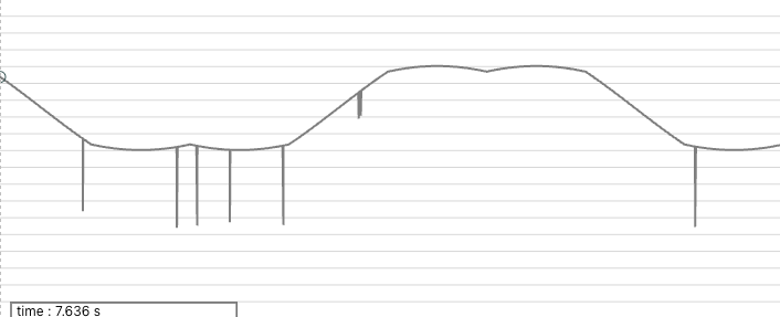

I recently started playing with CubeMonitor - it's fantastic. I am using it to troubleshoot/fine tune a motor control project I'm working on - specifically, I am graphing the values I'm calculating for Space Vector Modulation to make sure things are working as I expect.
Something odd I notice are these strange "glitches" in my waveforms:
There is nothing obvious I can find in my algorithm that might cause these - I am wondering instead if they might be coming either from 1) some nuance in C I might not be aware of, or 2) something I don't have configured properly in CubeMonitor.
To check the former: in my SVM algorithm, I do something like:
typedef struct {
    float theta_rad;
    float u, v, w;
    float alpha, beta;
    float d, q;
} FOC_HandleTypeDef;
void calculate_svm(FOC_HandleTypeDef *foc)
	// ... some stuff happens before this,
	// but at one point I use some members of
	// FOC as 'inputs'
	float uvw_min = fminf(foc->u, fminf(foc->v, foc->w));
	float uvw_max = fmaxf(foc->u, fmaxf(foc->v, foc->w));
	float wave = (uvw_min + uvw_max);
	// .. then write back out to them as 'outputs'
	foc->u += wave;
	foc->v += wave;
	foc->w += wave;

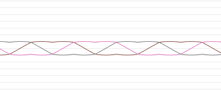

I notice that if I restructure my code to look more like this:
typedef struct {
    float theta_rad;
    float in_u, in_v, in_w;
    float out_u, out_v, out_w;
    float alpha, beta;
    float d, q;
	// let's separate the 'input' members from
	// the "output" members, and be more
	// explicit about things.
	float uvw_min = fminf(foc->in_u, fminf(foc->in_v, foc->in_w));
	float uvw_max = fmaxf(foc->in_u, fmaxf(foc->in_v, foc->in_w));
	out_u = foc->in_u + wave;
	out_v = foc->in_v + wave;
	out_u = foc->in_w + wave;
	foc->out_u = out_u;
	foc->out_v = out_v;
	foc->out_w = out_w;
So here I am not reading from and writing to the same member variables in my input struct. When I do this, I notice the "glitches" go away in cubeMonitor:
 I'd like to understand why this might be? I am doing all of this work in a simple while loop at the moment while I test my code - there are no interrupts or any apparent contention for the variables I'm working with:
FOC_HandleTypeDef foc;
foc.theta_rad =  0.0f;
foc.d = 0;
foc.q = 1;
while(1) {
        calculate_svm(&foc);
        foc.theta_rad += 0.001f;
        osDelay(pdMS_TO_TICKS(1));
 Thank you! And apologies if it turns out this is more a C question than a cubeMonitor question...were it not for cubeMonitor I'm not sure I would have uncovered this.

Experimenting with this more (and reflecting on it a bit), I think what might be happening here is that cubeMonitor is sampling this memory location in a way that is not synchronized with the frequency that the code is running, and so it's picking up my u/v/w values in 'in-between' states of calculation - the glitches are consistent with what my values are before/after the offset operation I'm doing to them. And further experiments where I perform several operations to a location in memory show similar results. Pretty interesting to learn.
