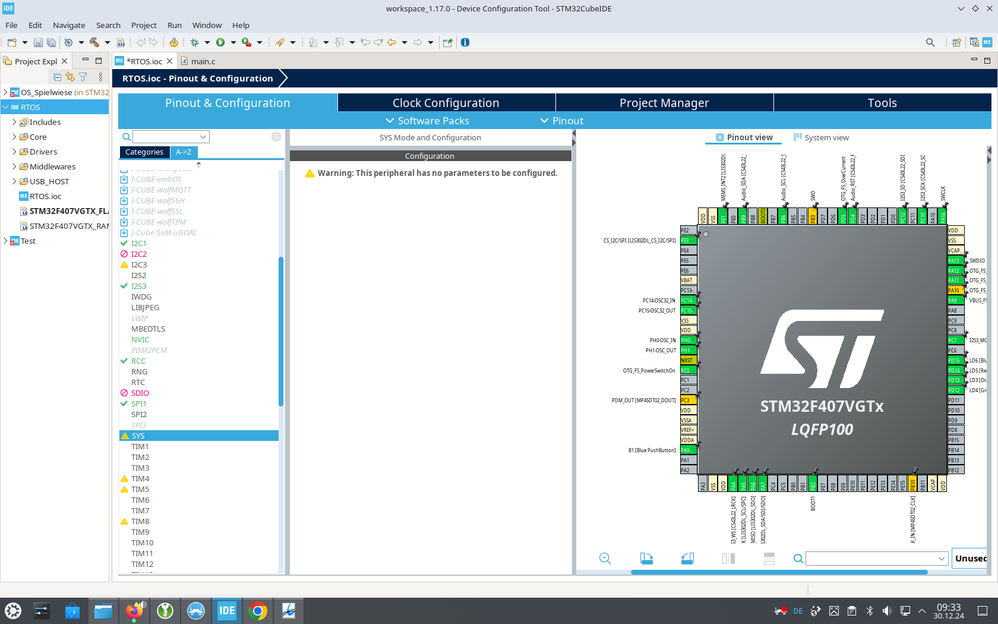

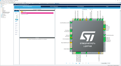

I just started a new project with FreeRTOS on the board.
When generating code via MX, there is a message about Systick configuration issue.
The problem is, I cannot change the configuration about SYS and TIM.
What can be the issue? What do I have to change in config?

Hello @stefluik
To view the SYS mode and configuration, try dragging the configuration window down.

Thanks. What a nice feature.
