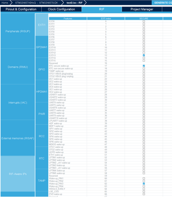

Cube MX v6.17.0 and even previous version v6.16.1 have a problem generating SystemIsolation_Config for STM32N6.
I made a test IOC file. There are 3 SECURE checkboxes checked in RIF -> RIF Aware IPs -> EXTI1:
  • Line 13 for  EXTI13
  • Line 17 for RTC secure-wakeup
  • Line 62 for Wake-up PIN3
Screenshot:
Generated SystemIsolation_Config(void) in main.c of FSBL contains:
  /* set up EXTI configuration */
  /* EXTI13 line */
  HAL_EXTI_ConfigLineAttributes(13,EXTI_LINE_SEC|EXTI_LINE_NPRIV);
  /* RTC secure wake-up line */
  HAL_EXTI_ConfigLineAttributes(17,EXTI_LINE_SEC|EXTI_LINE_NPRIV);
  /* Wake-up_PIN3 line */
  HAL_EXTI_ConfigLineAttributes(62,EXTI_LINE_SEC|EXTI_LINE_NPRIV);

The assert condition check macro is very messy, but it appears like it expects type and register mask with it so I added them (based on table 138. EXTI line connection in RM0486 Rev 3):
  /* EXTI113 line */
  HAL_EXTI_ConfigLineAttributes(EXTI_REG1|EXTI_GPIO|13,EXTI_LINE_SEC|EXTI_LINE_NPRIV);
  HAL_EXTI_ConfigLineAttributes(EXTI_REG1|EXTI_DIRECT|17,EXTI_LINE_SEC|EXTI_LINE_NPRIV);
  HAL_EXTI_ConfigLineAttributes(EXTI_REG2|EXTI_DIRECT|(62 % 32),EXTI_LINE_SEC|EXTI_LINE_NPRIV);
Note that line number 62 must be re-indexed for second register.
HAL_EXTI_ConfigLineAttributes function comment does not say that it expects such things from ExtiLine argument. So HAL needs some documentation update also.
