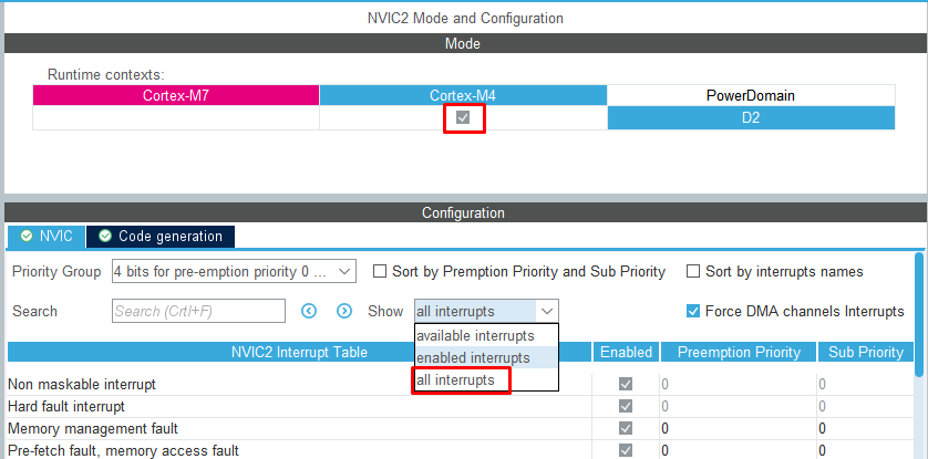

When I activate DMA in MEM2MEM mode, there is no way to tell the STM32CubeMX tool that I want it's IRQ Handler to be generated on M4 side - like for every other periphery.
It always generates it at M7's side no matter if I choose to show all interrupts at the following picture and tick one that I want at M4's side.

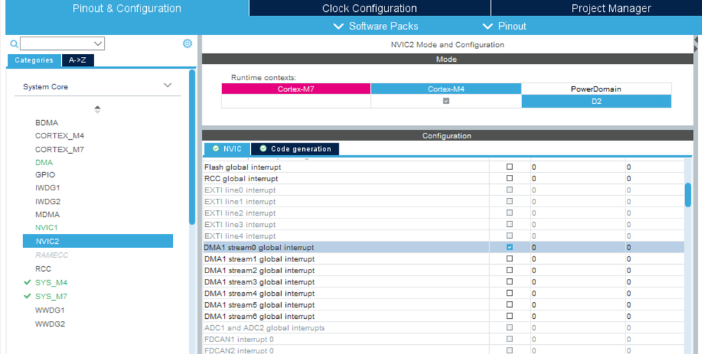

In fact, I can partially reproduce the issue from my side: When showing all interrupts in the NVIC2 Interrupt Table, DMAx Streamx global interrupts are displayed in the table:
After enabling DMA1 Stream1 global interrupt (for example), hdma_memtomem_dma1_stream0 is correctly initiated in the generated stm32h7xx_it.c file (under CM4):
/* External variables --------------------------------------------------------*/
extern DMA_HandleTypeDef hdma_memtomem_dma1_stream0;
But the function DMA1_Stream1_IRQHandler(void) handling the DMA1 stream1 global interrupt is not generated.

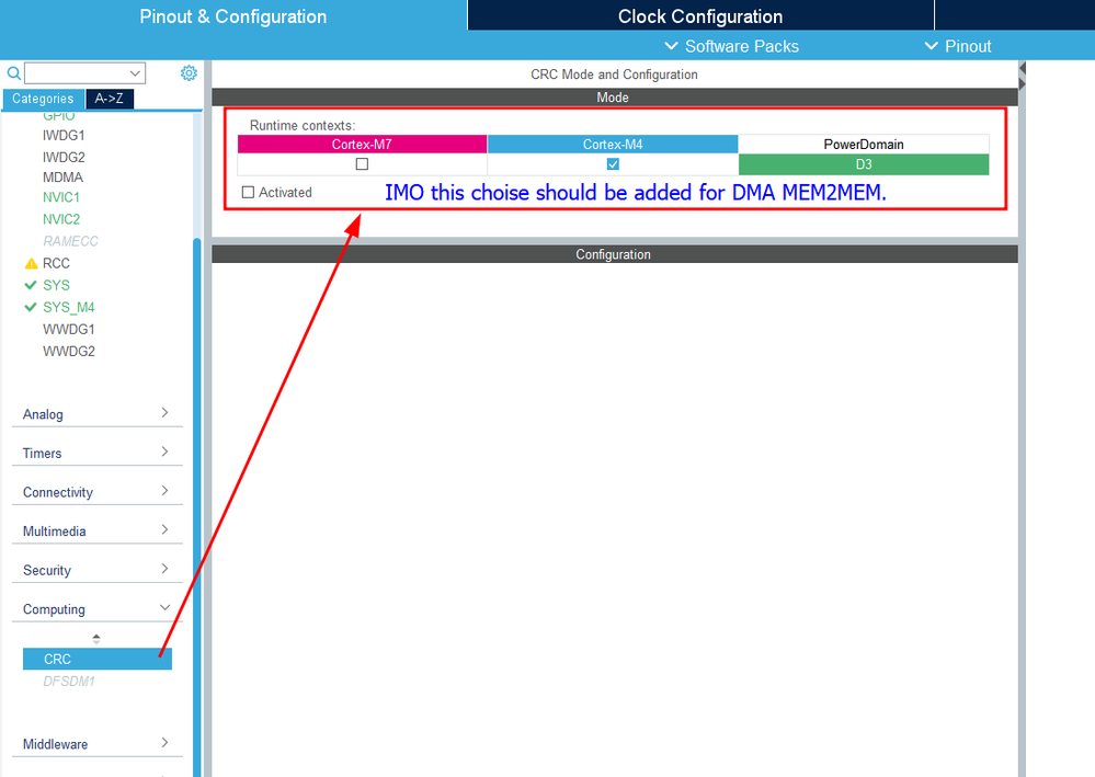

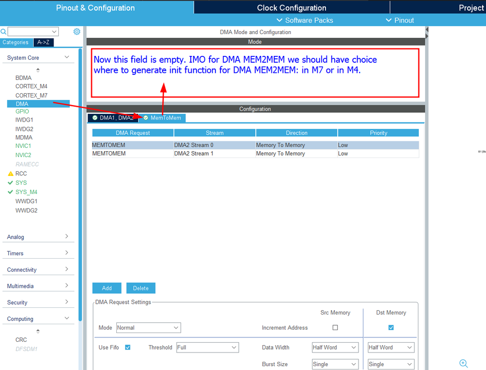

IMO for DMA MEM2MEM we should also have choice where to generate init function: in M7 or in M4, as it is for e.g. CRC:
Is there any update on this topic?
