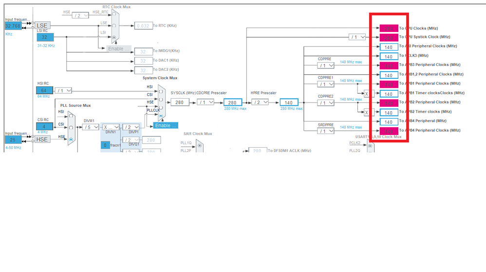

0693W00000JOyGXQA1.pngClock doesn't allow adjustments. Normally it shouldn't give a warning.
Muhammed Güler
Senior III
Check the power regulator voltage scale setting in the RCC settings. If power regulator voltage scale 3 is selected, you cannot exceed 200MHz

Jaroslav BECKA
which particular STM32H7 part is that (e.g. STM32H723ZG)?

Hello @Community member​,
When the configured values are highlighted, it means that they are out-of-range and there might be potential issues.
A solver feature is proposed to automatically resolve such configuration issues. You can click on "Resolve clock issues" so that STM32CubeMX proposes you the adequate values.
