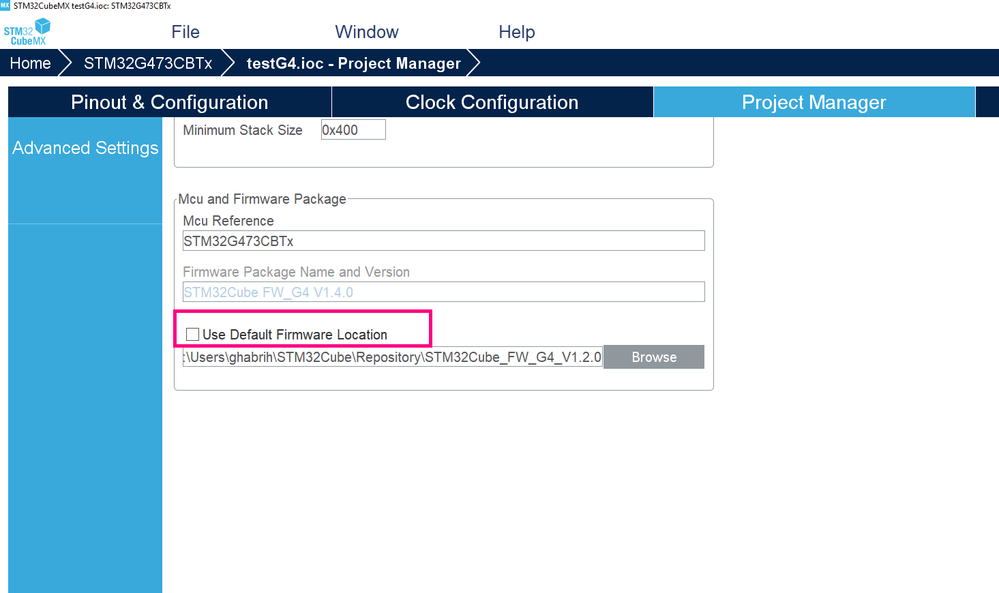

Hi @Rüdiger Becker​ ,
Let me be sure that I understand the issue, CubeMX doesn't allow you to downgrading  to STM32G4 1.2.0 version? If yes you can select any  STM32G4 firmware version available in your repository by unselect "Use Default Firmware Location" in Project Manager TAB and select the 1.2.0 version :
Or may be you mean that the code generated by CubeMX for OPAMP5 is not correct? If yes can you please tell me which parameter or is wrong ?
