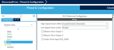

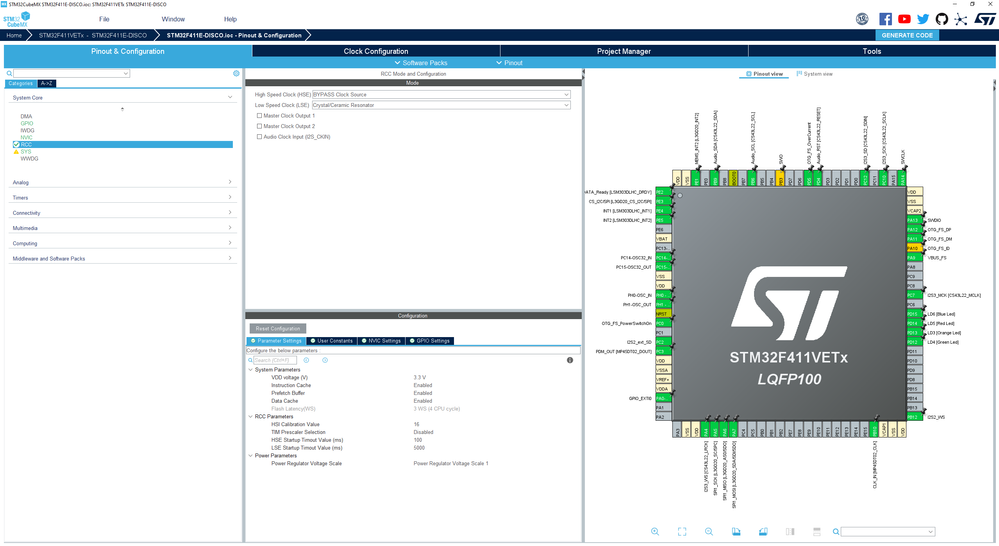

The default clock settings in CubeMX are:
High Speed Clock (HSE): BYPASS clock source
Low Speed Clock (LSE): Crystal/Ceramic oscillator
This causes the MCU to go into Error_Handler() after going into SystemClock_Config()
How to fix:
Change High Speed Clock (HSE) to Crystal/Ceramic oscillator
Low Speed Clock I think should be disabled.

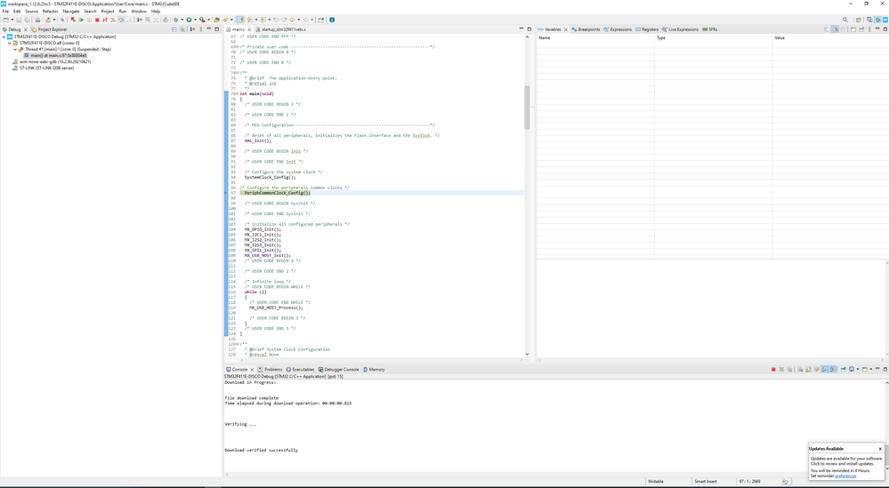

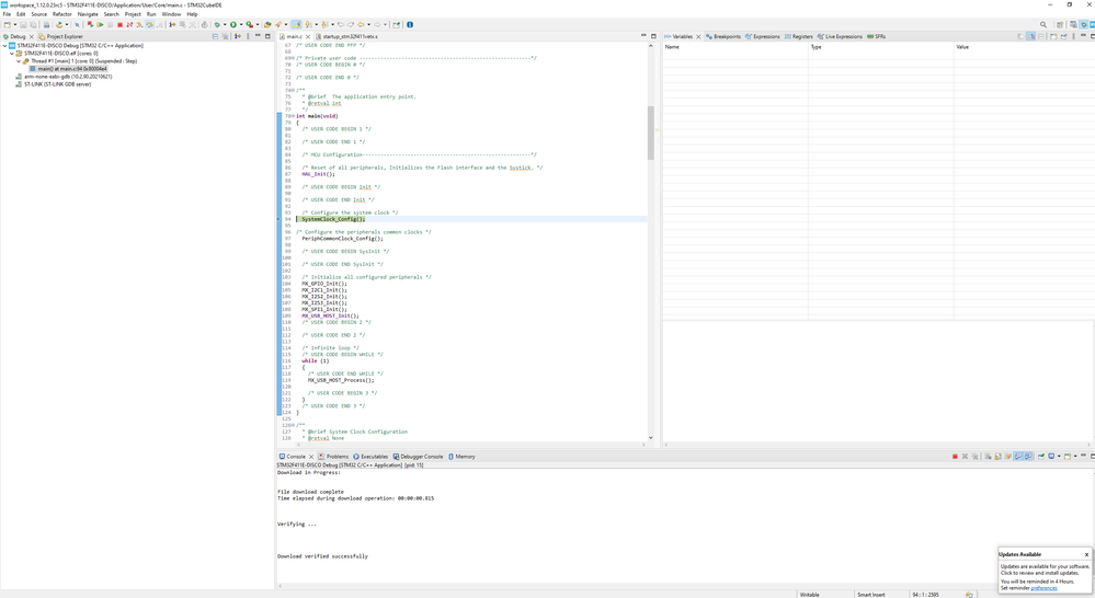

Hello @Community member​
I tried to reproduce the issue mentioned above but everything is working just fine .
Please check the screenshot :
Using CubeMX 6.8.1
_legacyfs_online_stmicro_images_0693W00000bjE03QAE.pngAfter generating the code and debugging it , there is no Error_Handler()
I will be waiting for your feedback .

Most of the DISCO / NUCLEO are BYPASS for HSE because the clock source is being feed via an 8 MHz feed from the ST-LINK/V2-1 or V3 (8.33 MHz) MCO pins.
Very free have the HSE *crystal* populated, and only those which do need OSC_OUT driven.

You are fully right ab.31 !.
STM CUBEMX 6.11 + Board STM32F411E-DISCO  gives WRONG clock Setting by default.
and CORRECT SETTING is:
High Speed Clock (HSE)  must be Crystal/Ceramic oscillator
Low Speed Clock  disabled.
Mateusz3
Thanks, you helped me a lot. Only this configuration works. Remember that you have to disconnect and reconnect the board for it to work.
