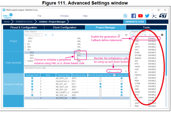

jnewcomb
Now supported in CubeMX. From the help PDF:
