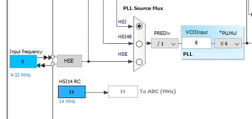

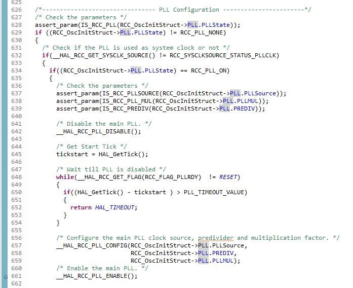

‎2018-07-02 4:32 AM
STM32 still resets..
This happens after executing ''__HAL_RCC_PLL_ENABLE();''
Does not matter if HSE or HSI is selected as input source of PLL. Without using PLL, STM32 runs fine.

‎2018-07-02 7:36 AM
FLASH latency setting?
