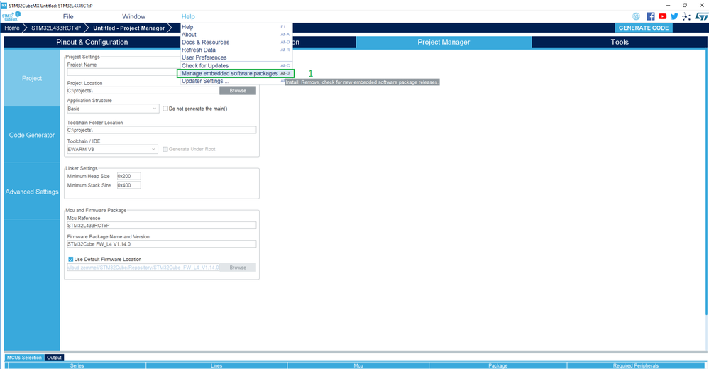

Khouloud ZEMMELI
1- Select "Manage Embedded Software Packages" under Help0690X000008wQbyQAE.png

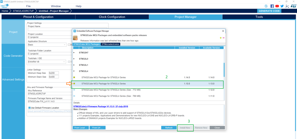

Khouloud ZEMMELI
2- check the small box

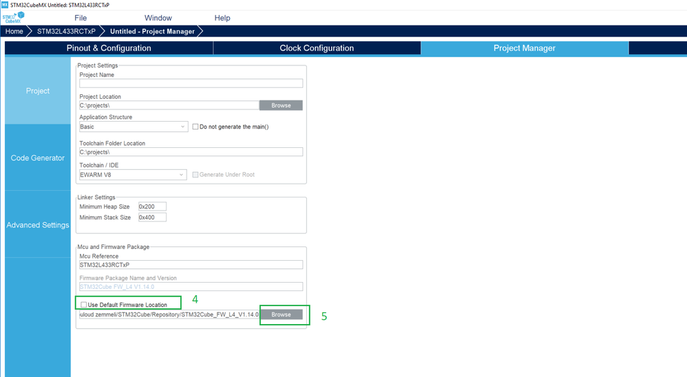

Khouloud ZEMMELI
Wait until the install finish then :
4- Uncheck the small box beside Use Default Firmware Location
5- Select "Browse"

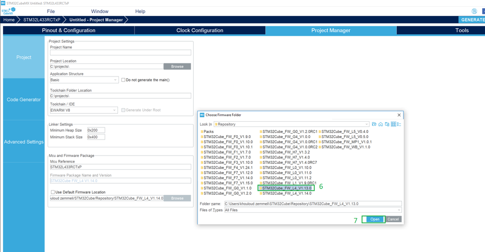

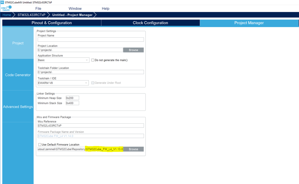

Khouloud ZEMMELI
6- Select STM32Cube_FW_L4_V1.13.0
7- Select Open
Khouloud ZEMMELI
that's all.
