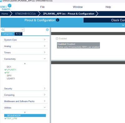

STM32CubeMX: "connectivity MWs not enabled"
Jason927
Version: STM32CubeMX 6.16.0
MCU: STM32WB15CCU6
Untilities Sequencer can not enabled, which says connectivity WM's not enabled.
But no "WM's" in connectivity page.
How to enable sequencer?

Souhaib MAZHOUD
Hello @Jason927
The "Active only if Connectivity MW's are enabled " means that this peripheral will only be active if one of the connectivity middlewares, such as BLE, THREAD, or ZIGBEE, is enabled under STM32_WPAN.

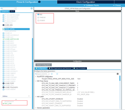

I'm already enabled BLE function, sequencer still in gray.
And without these seq files, STM32CubeIDE build failed.

I found after use AZRTOS_WB, sequencer is disabled. If not use AZRTOS, sequencer is OK.
Hello @Jason927
Yes, exactly, it is not possible to use both RTOS (ThreadX or FREERTOS) and the Sequencer on the same BLE project.
KR, Souhaib
You mean it is not possible to use RTOS with a BLE application.
Hello @Jason927
For a BLE, Zigbee or Thread applications. You can use the sequencer for the task execution on your application (ST’s implementation). You can also use an RTOS for the task coordination and execution. So, since RTOS and sequencer do the same job, you can use only one of them for your application. That means, you have to select an RTOS without sequencer or the sequencer without any RTOS.
