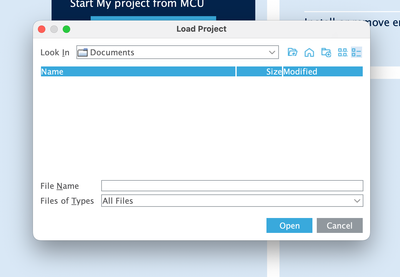

I recently switched to Mac Tahoe 26.1 and it seems since then stm32CubeMX 6.15 is not listing the contents of my Documents folder anymore. It doesn't seem like a rights management issue since
  • there were no changes to the Documents rights
  • they are identical to sibling folders which CubeMX would properly enumerate
And yes, the folder does have contents and is not empty as shown in the screenshot from the file open dialog attached.
Anyone experiencing similar issues? How to come around that?

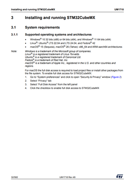

Hello @msedlak @SloBlo
The STM32CubeMX 6.16.0 is now available on the official website and it is supported on macOS 26 (Tahoe)

Now that I moved to CubeMX 6.16 and the support question is sorted, the issue is still persistent. Can we try to dig the original issue described above, now? As you can see in the screenshot, the Documents folder is not enumerated.
Thank you,
Oliver

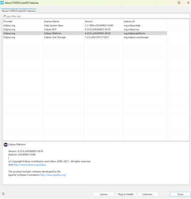

Hello @msedlak
At present, STM32CubeIDE 2.0.0 is built on Eclipse Platform version 4.33.0.v20240903-0618
The migration to a newer Eclipse version within STM32CubeIDE is planned for next year.
