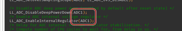

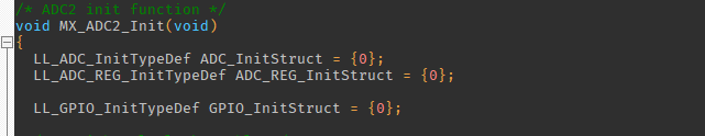

1. bug for ADC
the initialization should be ADC2, not ADC1. The same error for ADC3 initialization code.

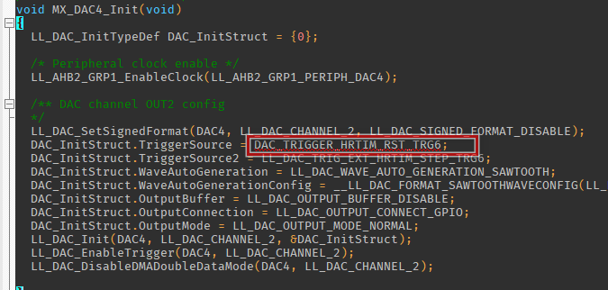

2. bug for DAC initialization code
the TriggerSource parameter should be LL_DAC_TRIG_EXT_HRTIM_RST_TRG6

Hello Bruno Hu,
Thanks for your feedback. Actually the first issue you have mentioned has been already detected and fixed, the fix will be available in the next release. Thanks for your patience.
Concerning the second point you raised, issue reproduced and it will be reported internally for fix. We will give you an update as soon as possible.
