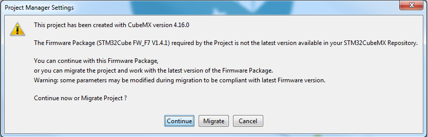

‎2017-03-28 6:12 AM
Hi Khouloud,
Isn't it a regression in CubeMX 4.20 because CubeMX 4.16 didn't have such a problem.
I'd appreciate If you could make the CubeMX compatible with older versions of FW_F7 as much as possible. Catching up with the latest version is not always an option, especially in developing firmware. Even a minor change requires a lot of testing as it may cause a timing problem or a crash.
If you don't have plan to support older versions of FW_F7, please provide us the link to download older versions of CubeMX. I've only found the link to download the latest version.
Hiroshi

‎2017-03-28 7:34 PM
Hi Khouloud,
Every version of CubeMX is dedicated to a specified firmware package versions.
OK. Then, will you provide the link to download older versions of CubeMX?
I've updated to 4.20 to prevent the nasty bug in 4.16. I'll try to find a version that works with
FW_F7 V1.4.1.
Hiroshi

‎2017-03-30 9:40 AM
Dear user,
Please find here the 4.16 version:
https://drive.google.com/open?id=0B3TGwFlypwI6NE5ncXVOV0ZpMjg
To avoid such situation, you may want to download CubeMX installations from st.com instead of the self-upgrade. This way you can keep both, your previously installed version and the newly released.
A 4.20.1 patch release will be delivered soon to fix 4.20 issues.
