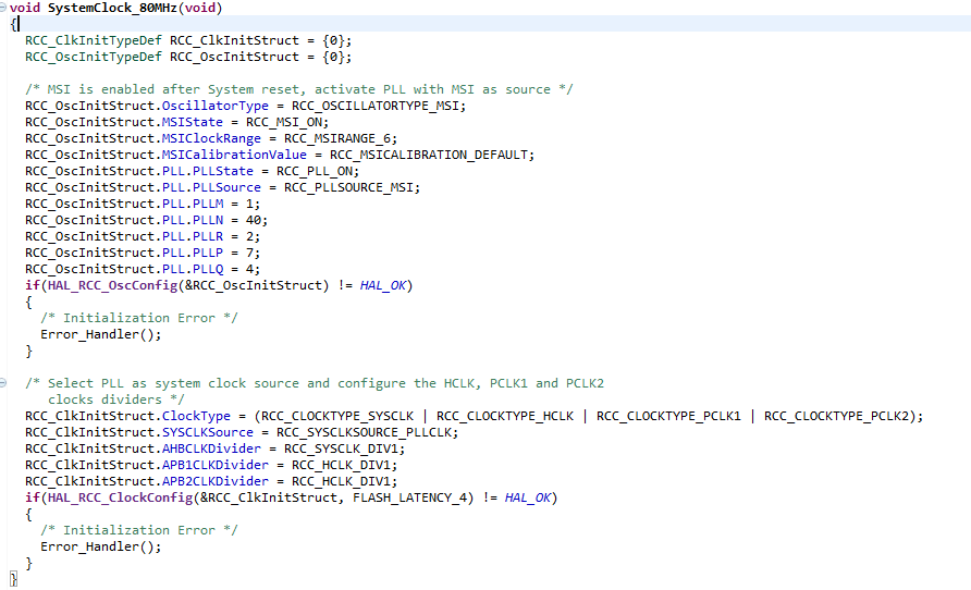

Im using Nucleo144 L4R5ZI board, using CubeMX i have generated the code to enabling the LPUART1 which the ST-Link is enabled for virtual COM port.
when i just took a simple private variable im trying to see the message on lpuart1 using HAL_UART_Transmit, nothing is being displayed.
Tried Debugging it halts the system on HAL_Init().
May be with the code generated or so??
When i tried with the example provided for the board,PWR/PWR_ModesSelection/Src it works fine, more over this code uses _GNU-...putchar ....redirecting to UART......and making the printf enable.
But i tried the basic way of getting the message on virtual COM port.
May be something missing in the code which is generated by CubeMX.
Thanks
Quite probably, not using CubeMX here.
Would look at PLLM setting, GPIO Bank G power enable, and LPUART prescaler

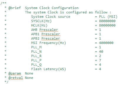

Hi
These are the below settings where working COM port:
Working example code:
CubeMX Generated code:
Where looked at the CubeMX generated code in SystemClock_Config
It uses the
 RCC_OscInitStruct.OscillatorType = RCC_OSCILLATORTYPE_HSE;
And the peripheral clock is also present.

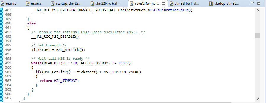

When i tired to debug the code which CubeMX generated, when it enters into the Debug mode, Target enters into the Halt state and
Waits for debug trigger to HAL_RCC_OscConfig
And prompt pauses at  499 line to READ the RCC and RCC_CR are at the Tick.

Posted on May 09, 2018 at 10:27
I would do this to insure the structures were clear/clean,
void SystemClock_Config(void)
RCC_PeriphCLKInitTypeDef PeriphClkInit = {0};
Posted on May 09, 2018 at 12:54
Hi Clive,
As you pointed out before, yes it is regarding the SystemClock_Config, in cubemx it picksup RCC_OSCILLATORTYPE_HSE.
Now i have fixed it up.
Thanks for your support and leads in directing towards the problem.
