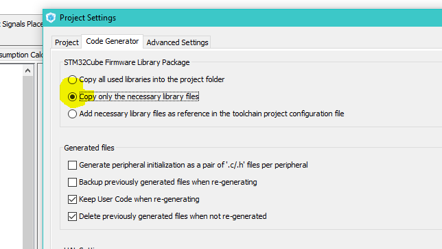

Posted on September 09, 2017 at 10:58
Hello!
For some reason  ''stm32l1xx_ll_rcc.c'' is not referenced from your project.
I found that the problem starts when you choose the highlighted options at settings.(first and second)
It is not enough to just change the option in your project.
Make a project without choose this settings  and will be ok
regards
vf

After the STM32CubeMX update to 4.1 and L1 driver update to 1.8.0 I noted the following:
- choosing the 'Copy only the necessary library files' radio button, allows a compilation without errors;
- the generated code remains un-functional.
I will put this aside, 'till the ST team solves the Low Layer driver for this board (project attached).
