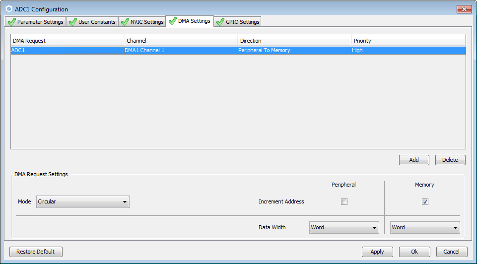

I have setup the STM32CubeMX project.. (STM32F302RExx)

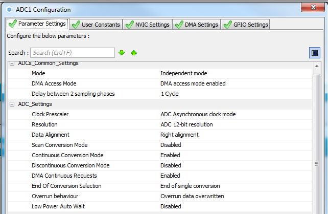

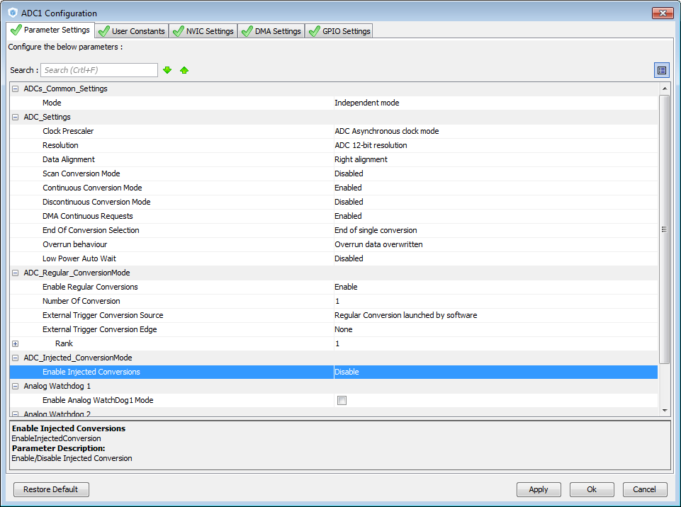

I use the ADC in continues / scan mode.
I have DMAContReq = true..
I then setup DMA on ADC1-CH1 with HIGH prio..
but when i generate my Cube-code... i don't see ANY code for the DMA setup ??
The ADC's works fine if i poll them.
This : 'DMA_HandleTypeDef hdma_adc1;' I see..
but thats IT .. no more references.. i have all in my MainFile..
Any clues ?
/M.H.

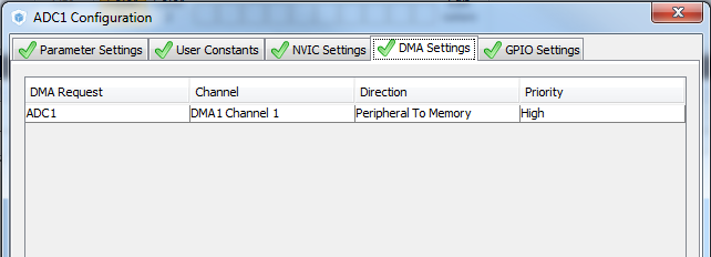

Posted on January 19, 2017 at 10:48
Hi
Holch.Mikkel
I'm using the 4.19 version,
the ADC
MSP Initialization with DMA configuration isavailableon
stm32f3xx_hal_msp.c file.
The MSP file ( located in your project Src folder) is generated automatically.
-Nesrine-

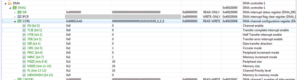

I can debug that the Code is being run, and the DMA is setup according to CubeMX Spec.
but then I don't know why it is not working.
Do you have to manual start DMA initially ?
 HAL_ADC_Start(&hadc1);
 uint32_t g_ADCBuffer1[16];
 HAL_ADC_Start_DMA(&hadc1, g_ADCBuffer1, 16);
If I do a Poll on the ADC i Read what i expect..
Does this look correct setup ? EN = 0 ??
