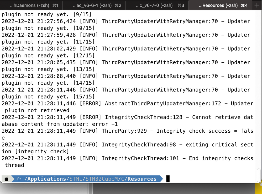

If I open cubemx using the terminal., I can find log messsge like: ThirdPartyUpdaterWithRetryManager:70 - Updater plugin not ready yet. [12/15].
Finally, cubemx reports IntegrityCheckThread:98 - exiting critical section [integrity check]. And It was stuck on the cover of cubemx.
PS: I using Apple M1 Pro on macos 13.0.1 (22A400)

I use ​./uninstall.sh to uninstall cubemx included java and .cubemx files. Then I reinstall stm32cubemx on my mac.
The problem was fixed. I can open stm32cubemx successfully with network connection.
