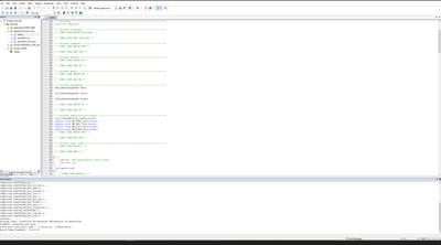

I am generating code with CubeMX for STM32F030R8Tx
When building this code as is , I get tons of problems:
45 Error(s), 152 Warning(s)
Can someone please help me to get this working? Perhaps this is a compatibilty issue between the CubeMX version and the Keil uVision?
It appears that this file is located in a completely different path on this PC compare to the other 'h files than where it is looking. There are 45 of the same missing file error :
Error Example:
C:/Users/Admin/AppData/Local/Arm/Packs/Keil/STM32F0xx_DFP/2.0.0/Drivers/STM32F0xx_HAL_Driver/Src/stm32f0xx_hal_adc_ex.c(50): warning: In file included from...
C:/Users/Admin/AppData/Local/Arm/Packs/Keil/STM32F0xx_DFP/2.0.0/Drivers/STM32F0xx_HAL_Driver/Inc\stm32f0xx_hal.h(46): warning: In file included from...
./RTE/Device/STM32F030R8Tx/STCubeGenerated/Inc\stm32f0xx_hal_conf.h(201): error: 'stm32f0xx_hal_exti.h' file not found
#include "stm32f0xx_hal_exti.h"

I have just managed to get rid of all the the warnings by adding:
-Wno-invalid-utf8 -Wno-empty-translation-unit
The errors still persist and I cannot seem to fix that even by adding the correct path to where the missing file is located
Doing that, creates tons and tons more errors of duplicate declarations etc.
It appears however that this gets ignored by the compiler and the warnings are still generated as before
The errors still persist.

Hello @Bernt
Actually I created a project based on STM32F030R8Tx using CubeMX 6.9.1 where I activated few IP then I generated and built the code using keil , this is what I got 0 errors 0 warnings
Could you please provide your ioc in order to push further the investigation.
Thx
Ghofrane
